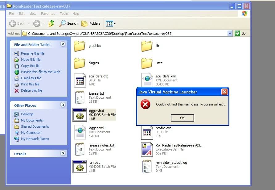

OK, I unzipped (to desktop, is that OK?) and then double-clicked on the .bat files, both came up with this:
What step did I miss?
Looks like the logger.bat is selected.
Double click the run.bat.
AIM: TguiWRX

Same thing happens!

I just re downloaded the enginuity rev037 test release, extracted it again, run both .bat files, same thing as the above pic.
I am running XP on a laptop, what gives???????

Dumb question: do you have java installed on the laptop?
It is in my program files, so I think so.
How do I check to see if it is running? I looked in the task manager and didn't see java there under processes.
