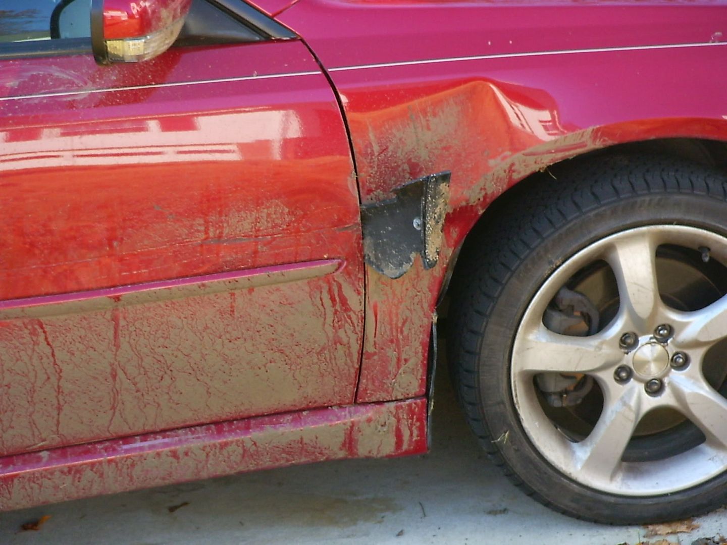

can't open my passenger side door.... :(
