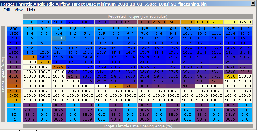

Having some issues with some of these trying to figure out the size of the tables.
For example attached is what I come up with for the target throttle angle.
Obviously I've got the RPM axis too big by 4 cells but not sure about the requested torque axis. I guess if I could measure this, I could go see how high the value goes when I drive.
The fix for the rev hang is to reduce the target throttle angle idle airflow target base minimum to a smaller number???

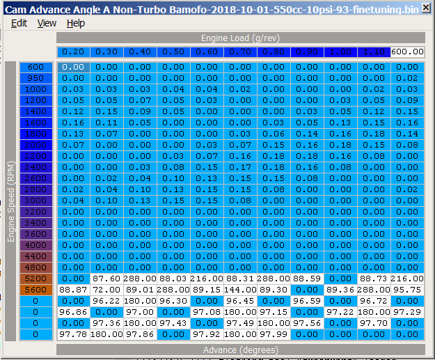

For AF Correction I had in a different location. I wonder if they are different values per rear o2 sensor (this has 2 front and 2 rear)? I had 20114.
Here is the cam advance. I'm guessing the valid cells are Load 0-1.10 and RPM 0-4800?
In theory the load would be modified, since I am hitting load 2.3+ now. This may not be a table I really need to mess with based on how small these values are.
PS Can I PayPal you some money for your time? Thank you.

For the rev hang, I am going to match the last value below 100 all the way up to redline and see what happens.
That is , if it's 30.6 before it changes 100, I'll run it 30.6 from the first instance of 100 to the last instance of 100.
A little confused about the X axis. Other values in the ECU for torque only go up to 100 . So not sure what is correct here. Also when I go drive, the max requested torque I see is 100%. Perhaps this is a different scale?
The scale looks more like g/s to me if I had to guess. What else goes up to a raw value of 375 ?
Certainly 16 cells X by 16 cells Y looks correct.

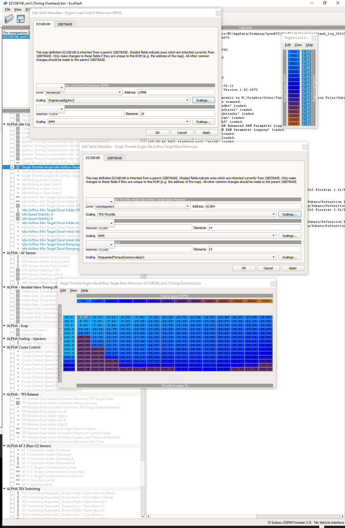

Just wanted to confirm that the addresses you found worked great, table shown in attached screenshot, as well as the load limit b table, with addresses, just in case someone looking to tune this ecu comes across this post.
Edit: Apologies for the boxes covering the addresses, if anyone knows how to correct that issue, please do let me know! See previous post for addresses for the idle table. The load limit b table addresses are as follows: Engine Load g/rev is c2988, RPM is C293C, and the table includes 19 rows and two columns of data

Hi again and thank you for the additional information! I can definitely use the potential AF3 correction addresses with logging to find the actual address from here and will update this thread once I do.
Regarding the DBW tables, it is my understanding that the ECU determines the appropriate throttle plate opening angle by first referring to the "Requested Torque table" and determining a requested torque value based on the throttle pedal position and the engine RPM. This value is then plugged into the "Target throttle plate position" table (whichever one is active at that time) and used to calculate an appropriate throttle angle.
Under idle conditions, which I believe is any time the throttle pedal is 0%, I am not positive which table is used to determine the throttle plate position, but on my 2006 WRX, I can confirm that this is governed by the "Target throttle plate position (idle)" and "Target Throttle Plate Position (Idle) Minimum" Tables. Just FYI, my minimum TPS during idle on the WRX is 0.12% (stock and in my map). Perhaps the 2010 2.5i has a similar table?
In any case, I believe that the "Idle Airflow Min Target Decel Adder (RPM)" table in the 2010 2.5i ROM may be used in connection with the current ""Target throttle plate position" table to open the throttle more than it otherwise would be under these conditions, perhaps for the duration set in the "Idle Airflow Min Target Decel Initial Idle Activation Max Mode Counter" Table, which could definitely contribute to rev hang. I think that the "Target Throttle Angle Idle Airflow Target Base Minimum" table is then used to set a floor for idle throttle opening that could override a lower value determined from the "Idle Airflow Min Target Decel Adder (RPM)" table in conjunction with the "Target throttle plate position" table, which would explain why it has had an effect for some people.
Regarding turbo'ing the vehicle, no, I have no plans for that; already have the WRX pushing about 350WHP and the Forester is supposed to be my reliable daily driver to bring the children to daycare in ;) Just looking to get rid of the annoying rev hang issue, improve throttle response/ramping, and maybe get a few more horsepower/add a slight burble on overrun.
I only changed load limit B because it seemed so close to the loads the engine was capable of making stock, but I haven't really done much logging yet, so could be wrong (I just know that my WRX is making 3.4g/rev of load from ~3.4k RPM to ~5k RPM and barely tipped in I'd be exceeding the engine load limit b tables on the 2.5i ECU (table copied below for reference).

Overhauled Timing (pulled from Pickler's 2.5i base map, need to look into more before flashing, be careful!)
Remapped DBW Throttle to be more linear
Scaled Front 02 Sensor for wider range of reading
Lowered Rough Correction Delay (Increase IAM faster after flashing)
Expanded Rough Correction Range (high RPM knock now taken into account in determining IAM)
Smoothed OL Fueling
[/list]
Much thanks to Pickler for releasing his 08 2.5i base tune, on which much of my current tune is based.
EZ1GB10K_rev12 (Corrected Timing Tables - DO NOT USE PRIOR ROM REV).bin.zip [375.52 KiB]
