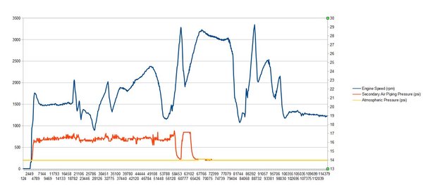

Next I looked into my secondary air system. Stuck open valves would result in a pre-turbo exhaust leak and therefore low boost.
So I logged Secondary Air Piping Pressure (didn't even know it had a pressure sensor in there?)
Again, it seems to be functioning normally. The pump is active during warmup resulting in pressure slightly above atmospheric (16-17 psi). The pump shuts off after about a minute (which was odd, I can usually hear it shutting off after about 15 seconds), and the pressure drops down to 13.9 psi, same as atmospheric pressure.
As with the TGV valves, I'm wondering whether there is any point in physically checking if the valves do indeed close as I'm not sure whether I would actually be able to see raised pressure in the secondary air piping if the valves weren't closing properly. I'm not sure the air pump will actually block any air (exhaust) from escaping once it's shut off? However, stuck valves *should* throw a code as well making it quite unlikely that this is the cause of my issue.
Just to make sure I'll unbolt the air pump and see if there are any exhaust fumes coming out of the hose when the engine is running. Just haven't gotten around to it yet.
