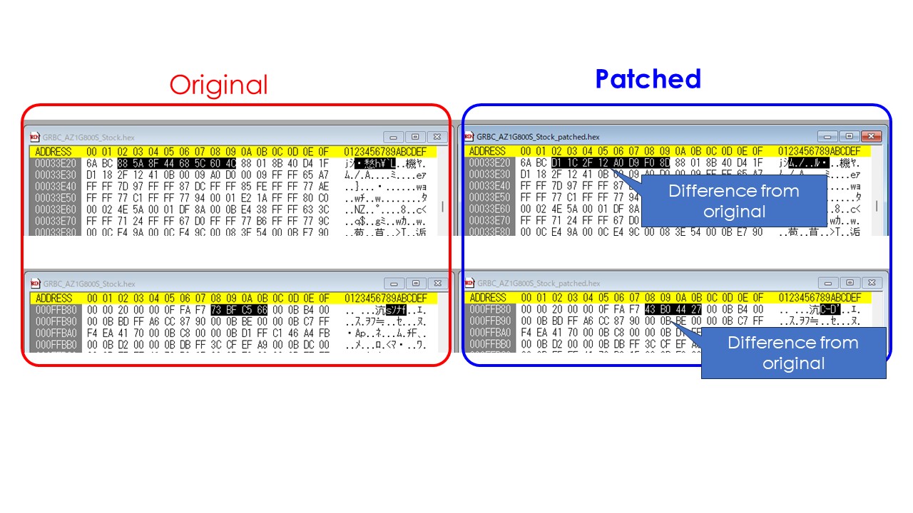

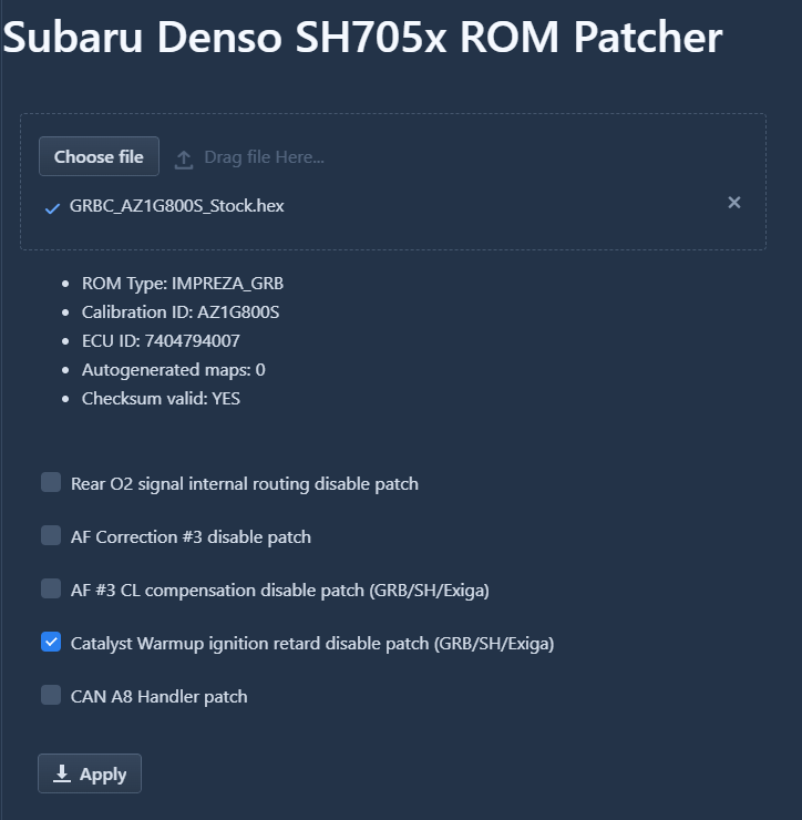

Hi, I uploaded AZ1G800S hex to below link.
http://apps.ecuresearch.ru:8080/rom-tools-web/
And I checked cat warm up staff, and then downloaded it.
Here is the rom comparison between original and patched.
And my question is, is this threshold to disable secondary air pump?
Please please please help me to disable this f*** secondary air pump system correctly!!! :D

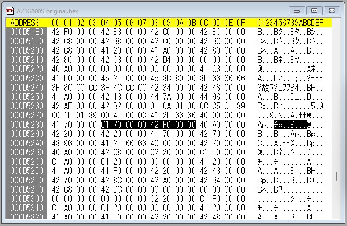

Cortin gave you more than enough information - the three tables you can find with Scoobyrom, and the -15 120 should be C1 70 00 00 42 F0 00 00 in hex. Find it in the ROM, test and report back.

I should forget Subaru Denso SH705x ROM Patcher for now, right?
I found "C1 70 00 00 42 F0 00 00" in original hex only at D5280,
and this should be air temprerature threshold for secondary air pump operation?
In order to disable pump operation,
"C1 70 00 00 42 F0 00 00" --> "42 F0 00 00 42 F0 00 00"(Min-15 Max120 --> Min120 Max120) souhld work.
Is my understanding correct?
