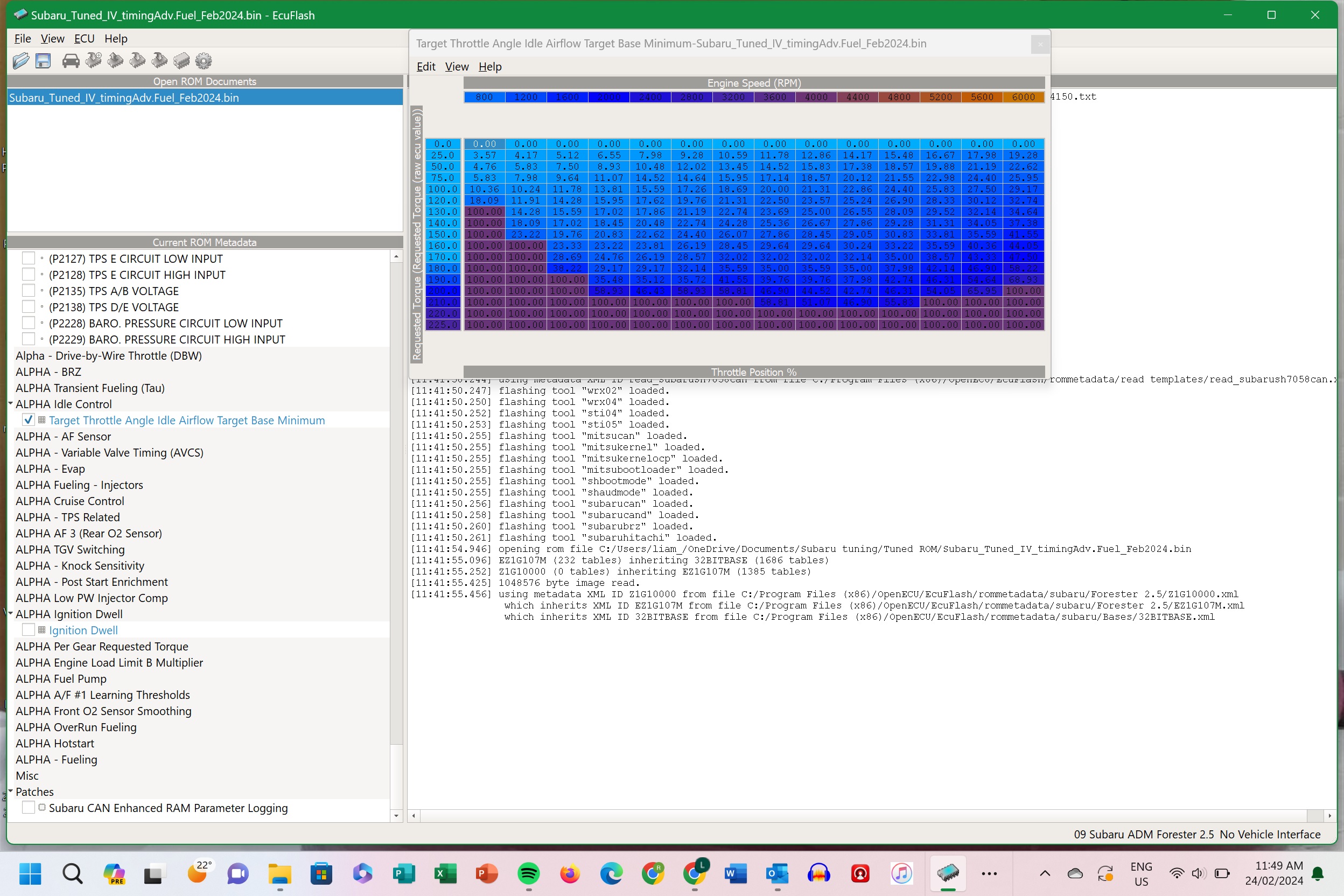

Hey all, Picking up on this thread, I am trying to resolve the rev hang in my 09 NA forester. I've grabbed the 32BITBASE and EZ1G107M files, but when I open my ROM, I don't get half the tables accessible that everyone is talking about. Can anyone help out?
Also wondering where the base CL fueling info is drawn from. I don't seem to have a VE table in my current definition.
Cheers
