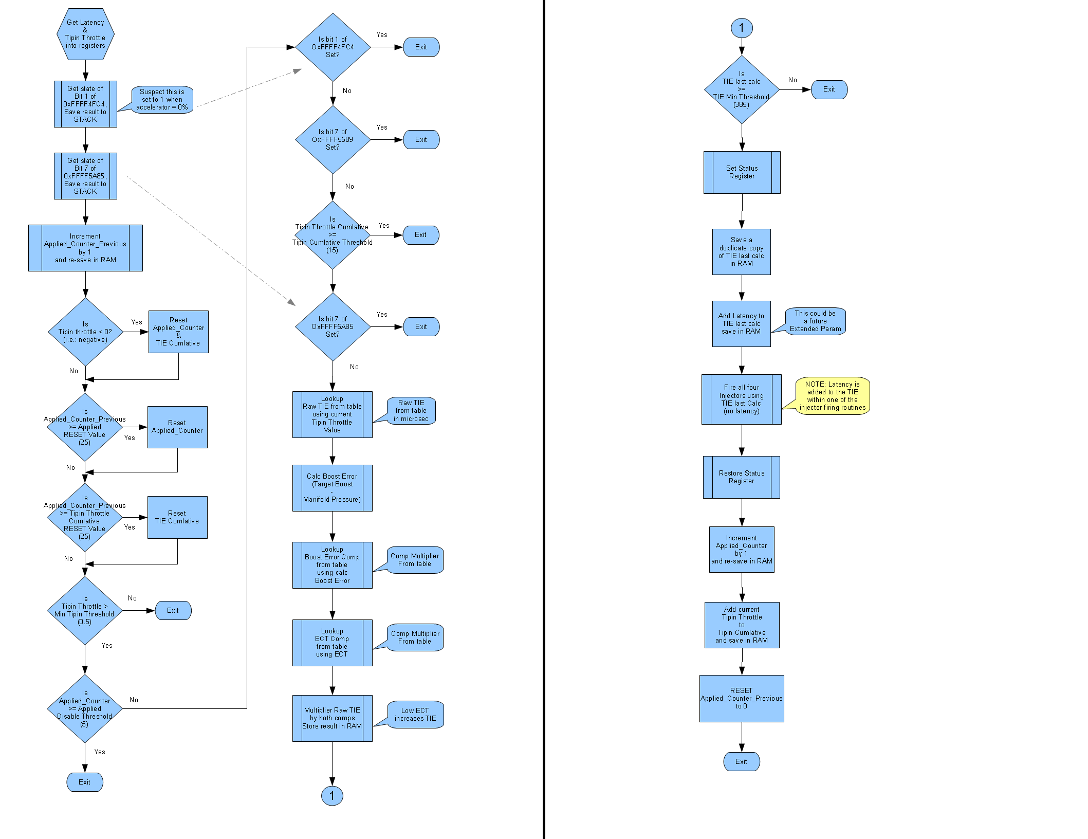

I ran through the Tipin code one more time and it appears that latency is added in one of the injector firing subroutines. The code that fires the injectors pulls in the raw Latency table look-up value and adds it to the compensated TIE value before writing the duration into the one-shot timer for each injector.
I also did some logging (32 bit ECU) and I believe the TIE routine is processed once every 8 - 10milli-seconds.
So, some interesting points come from this. For my stock ROM:
Disable Applied is set to 5, assuming 10msec for each count that means TIE is applied 5 times over 50msecs.
Applied Reset is 25, assuming 10msec for each count that means TIE is disabled for 250msecs after it's started unless reset by other means.
One thing that I was wondering about, with better engine air flow maybe higher TIE values is not the complete answer, maybe also adjusting the TIE duration could help.
I did this flowchart if anyone cares.
Here's a log with some of those un-revealed Tip-in parameters mentioned in the flow chart.
romraiderlog_20120302_082027.zip [1.26 MiB]
Downloaded 414 times

Fantastic chart dschultz! So much easier to understand the algorithm.
Do have one question. In the 4th block, you say 'is tipin throttle < 0 (or negative)'. Can you verify if you meant just less than zero or less than or equal to zero. The 'or negative' comment makes it seem like the block says 'less than zero or negative'. Which are the same thing... But I may be just reading that wrong.
Also, the latency not being added to the tip-in calcs correlates with Carbibbles' findings for the 16bit code.
EDIT - So latency IS added!
 Post subject: Re: Next Problem to be Cracked: Tip-In (Accelerator) Enrich
PostPosted: Mon Mar 05, 2012 4:35 pm
Yes, less than 0 is the same as negative dTPS (I can remove the "or negative" comment). The test result is "No" if dTPS = 0. But later you will Exit because dTPS does not meet the min threshold for dTPS.
