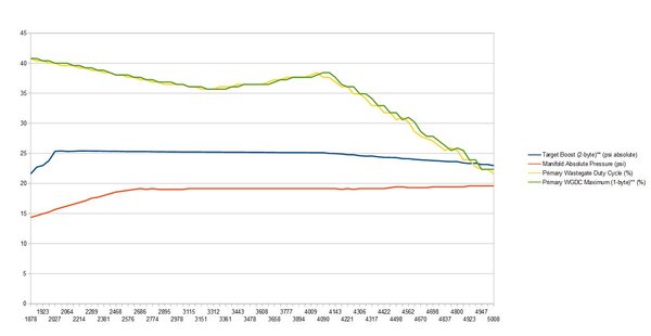

My car is a 2008 WRX (EDM), stock except for a 2.5'' catback, with 110k miles on it. It runs alright, but feels quite sluggish. I don't have another WRX to compare it to, but it sure doesn't feel like the 230 hp it should have.
So I've been doing some datalogging with the stock map to try and understand what it's doing, how the tables work and how they translate into running the engine.
These are the results:
I've attached the full log if anyone wants to take a closer look, but the graph works fine to show my point.
As you can see, the Boost Error is substantial throughout most of the pull. WGDC isn't adjusting accordingly, but actually decreasing way below initial WGDC values.
I took the Init and Max WGDC values from the rom's tables and put them into the graph as well to show what I mean. I do realize those will have been adjusted slightly by the low IAT - still, the actual WGDC curve should at least somewhat resemble the other two WGDC curves, right?
So, what's going on here? Why is the WGDC dropping like this?
I've already checked the BCV, it works fine. The vac lines are in good condition and the restrictor pills are in there as well. Initially, I thought that was the issue because 8.5 psi max boost to me sounded a lot like the BCV not working properly. But that still doesn't explain the WGDC curve, right?

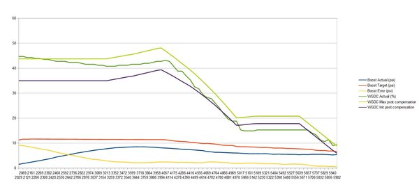

Wow - good info in your replies, thanks.
Looks like there are three tables playing a role here:
- Turbo Dynamics Proportional Compensation (IAT):
IAT was between 11°C and 14°C, resulting in Target Boost reduction somewhere around 20-30%.
When logging Target Boost, are the values pulled straight from the Boost Table or does TD Compensation get factored in as well?
- Initial/Max Wastegate Duty Compensation (IAT):
Again, IAT between 11°C and 14°C means WGDC reduced by 20-30%. This is definitely not represented in my graph because I pulled the WGDC values from the Rom.
- Initial/Max Wastegate Duty Compensation (atm. pressure):
I'm about 1000 ft above sea level, nothing unusual.
I did actually log atmospheric pressure in that pull, just deleted it from the log because i didn't think it was important. It was at 13.93 psi, which means WGDC gets reduced by 12.5% up to 4k rpm, up to to a whopping 70.3% reduction at 5k rpm! :shock: :shock:
Results:
Now, this still isn't 100% correct because I only added atm pressure compensation to Init/Max WGDC curves. They should be even lower with the IAT compensation added.
While it all makes a lot more sense now, I'm wondering if those WGDC Compensation values aren't a little too aggressive? I'm looking at a quite popular base map for an '09 wrx, atm. pressure compensation is set to -18% instead of the original -70.3%, and IAT compensation is set to -10% instead of -34.4% (at 10°C).
How far should I be able to go safely, without risking the turbo? Is it the simple matter of making sure I don't over-boost or is there more to it?
I will definitely have to do something about that...
Atm.compensation is not to prevent overboost, it's to avoid what i think is called "compressor surge", and thus to save the turbo itself.
09 wrx uses a different (bigger) turbo that works better at altitude, that's why there's less atm.pressure compensation.
I think you should focus on the area below 4000rpm first. You should be able to get much closer to target boost in that area, regardless what altitude you're at. 8 psi is barely above wastegate spring pressure, so if this really is what you get, there has to be a mechanical issue, and i would be careful messing with WGDC in that case. ;)
Maybe try logging MAP (Manifold absolute pressure) and Atm.pressure as well, that's how i usually do it.
You could also try to zero your WGDC (set "Max Wastegate Duty Limit Post-Compensation" to 0) to see if you get wastegate spring pressure boost correctly. (should be around 6-7 psi).
