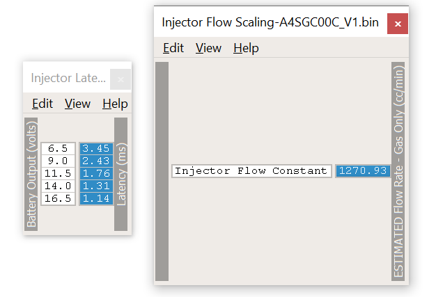

COBB Tuning Surgeline Tests NEW Deatschwerks 1300cc Injectors on Built STi!
https://forums.nasioc.com/forums/showpost.php?p=31703060&postcount=11
DW-21S-01-1300-4
6.50v - 3.45ms
9.00v - 2.43ms
11.5v - 1.76ms
14.0v - 1.31ms
16.5v - 1.14ms
Scaler: 1270.93cc (or 2130 for COBB Tuner software)
My current values
[Table2D] Injector Flow Scaling
Injector Flow Constant <- Should this value be the 1270.93 from the Scaler value from above?
724.9839314408141
[Table2D] Injector Latency
6.5 9.0 11.5 14.0 16.5
2.976 1.752 1.244 0.9480000000000001 0.644

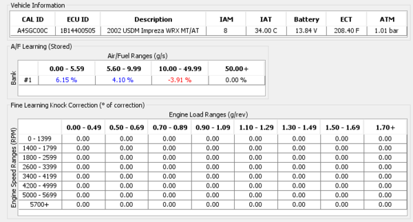

2. Rescale MAF for closed loop
How To: Use Learning View to verify closed-loop MAF scaling
viewtopic.php?f=33&t=4899

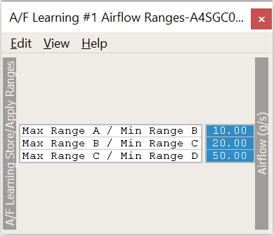

NSFW mentioned I should A/F Learning # 1 change because of the 5-10 range is useless and helps with tuning and some people left it.
[Table2D] A/F Learning # 1
Max Range A / Min Range B Max Range B / Min Range C Max Range C / Min Range D
10 20 40
My current values
5.5984500509999995 10.002136844999999 50.001528951

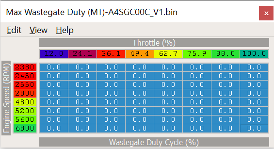

1. Change WGDC to all "0" to prevent blowing up engine. Should I also update the (AT) tables too where they are the same as the (MT). When done do I revert my values? or is this another ball game?
[Table3D] Max Wastegate Duty Cycle (MT)
12.048441952385337 24.096883904770674 36.14532585715601 49.39792260318047 62.65051934920493 75.9031160952294 87.95155804761472 100.00000000000006
2380.078125 0.0 96.09375 96.09375 96.09375 96.09375 96.09375 96.09375 96.09375
2450.0 0.0 96.09375 96.09375 96.09375 96.09375 96.09375 96.09375 96.09375
2550.0 0.0 36.71875 36.71875 47.65625 64.84375 89.0625 89.0625 89.0625
2800.0 16.015625 16.015625 16.015625 35.15625 60.15625 69.921875 69.921875 69.921875
4800.0 21.875 21.875 26.953125 37.109375 60.15625 69.921875 69.921875 69.921875
5200.0 20.703125 20.703125 23.828125 35.15625 53.90625 64.84375 64.84375 64.84375
5600.0 19.140625 19.140625 20.703125 33.59375 50.0 62.890625 62.890625 62.890625
6800.0 0.0 0.0 0.0 0.0 0.0 0.0 0.0 0.0

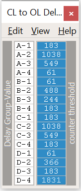

2. Change CL/OL delay to half the stock value. Why is this done I can find a reason for it yet will do more reading for a post about it but lost the link will update when I find it. Same question when I'm done do I need to set to my original values or leave it?
[Table2D] CL to OL Delay
A-1 A-2 A-3 A-4 B-1 B-2 B-3 B-4 C-1 C-2 C-3 C-4 D-1 D-2 D-3 D-4
366.0 2075.0 1098.0 122.0 122.0 976.0 488.0 366.0 366.0 2075.0 1098.0 366.0 122.0 732.0 366.0 3662.0
New Values
183 1037.5 549 61 61 488 244 183 183 1037.5 549 183 61 366 183 1831

Here is another thread with link to spreadsheet and more info for logging data for this task. Using MickeyD2005's CL scaling spreadsheet:
2a.
How To: Closed Loop MAF Scaling
viewtopic.php?f=33&t=5404
I will used Using MickeyD2005's CL scaling spreadsheet but In the previous thread he said it was not accurate. anyways I will log with the values specified for my logs
4. Once connected, click the "Dashboard" tab, and select the following parameters:
A/F Correction #1 (%)
A/F Learning #1 (%)
A/F Sensor #1 (AFR)
CL/OL Fueling* (status)
Engine Load (Direct)* (g/rev)
Engine Speed (rpm)
Fuel Injector #1 Pulse Width (Direct)* (ms)
Manifold Relative Pressure (psi)
Mass Airflow (g/s)
Mass Airflow Sensor Voltage (V)
Throttle Opening Angle (%)"

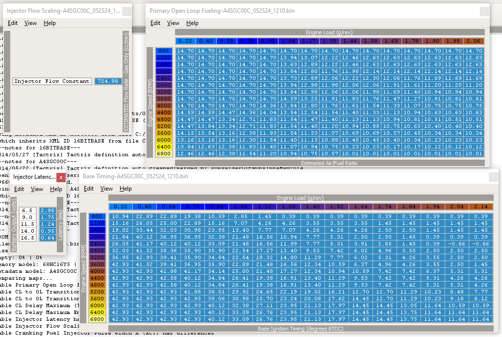

1. Pulled ROM from JDM V8 ECU and the USDM WRX ECU. And working on a base map.
Current WRX Map
I did a compare of my current WRX Map with a base map and from what I have read and learned so far I think I got taken. I hope I am wrong but here is what I have found, let me know what you think should this run my car with the current setup? I see no changes in tables like MAF, Boost etc.
EcuFlash Compare Log

Set A/F Learning #1 Airflow Ranges
Set CL to OL Delay to 1/2 value
Keeps fuel economy and ?

Set Max Wastegate Duty (MT) & (AT) to 0
Keeps the the turbo from making boost
Set Primary Open Loop Fueling
Need to figure this out

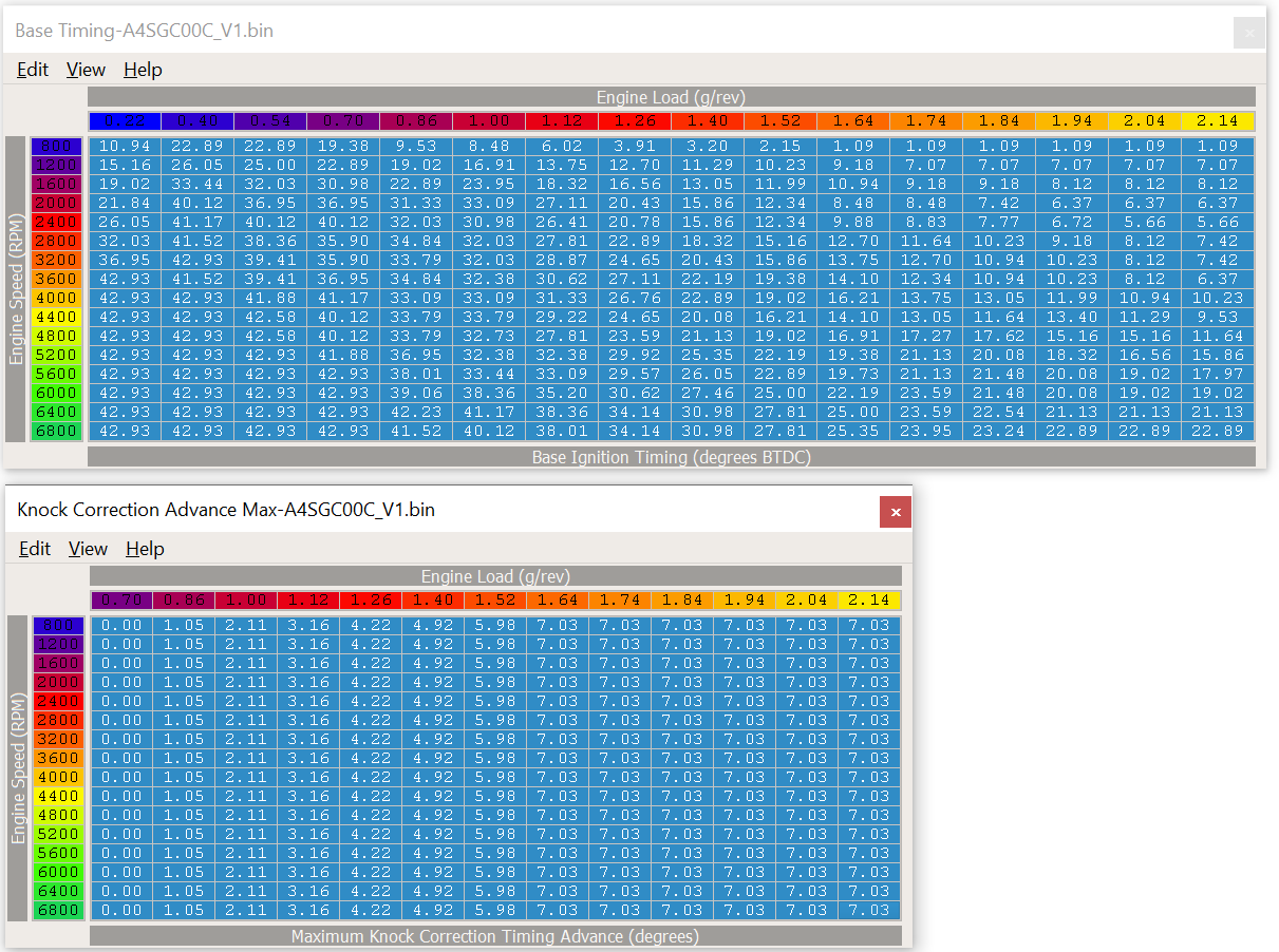

Set Base Timing & Knock Correction Advance Max
I cleaned up the KCAM table and Set Base Timing Values to match OEM Total Timing. I am suck on removing 5 deg and smoothing this out.

 Post subject: Re: 02 WRX Tune Help
PostPosted: Fri May 31, 2024 6:40 am
Posts: 3264
sparcomx wrote:
1. Cleaned MAF sensor it was really dirty.
2. Took Intake off replaced gaskets and all the old pvc hoses had an oil leak.
3. Replaced TMIC silicon elbow
4. Installed a new oil pressure and boost gauge, have EGT but not installed yet.
5. Replace all the silicone hoses for the 3 port gm boost controller
5. Wired up the LC1 with gauge.
6. New K&N air filter I need to put wheel liners the old filter was really gross.
Cleaning the MAF, what most people do here is actually they are just cleaning the air temp sensor bulb not the MAF part as its up inside the maf housing. Personally if its horribly dirty I would just replace it.
For the manifold, do a leak test and make sure that there is definitely no mystery air sneaking in somewhere. Then you'll be in a position to do some actual tuning - but I'm not sure what you're planning to do with the v8 jdm rom vs your USDM one? To start tuning your turbo in, start at 0% min/max wastegate duty - you'll need to fix your AFR and timing first (by tuning maf and injector settings) then when you can do a complete pull with a good AFR and no knock you'll be ready to start adding in wastegate duty and increasing the boost.
You could use the values from that other post if they are for the same injectors you have - it will only be a starting point anyway as you'll still have to make adjustments for the intake.
I cleaned the wires with a qtip gently with some CRC MAF cleaner then I blasted it out, But I did placed an order for a new MAF. And If you see my update on my last post from today I have a bad feeling I have a really bad tune. I have a smoke machine how much psi should I test this at? I only used it at 5psi on a NA ford, But doubt I have a leak since I changed all the joints. I will be tuning both but starting with the USDM since I live in CA and need it :).
