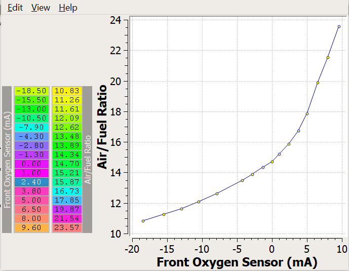

I have been having unstable idle problems since I have had the car. I was watching the stock o2 sensor at idle and noticed it jumped up and down alot. I ended up comparing the stock o2 with my wideband and noticed it wasn't accurate. I rescaled my o2 sensor to reflect the output from the wideband taking into account the delay from being farther down stream. The idle is rock solid now.
I attached pictures of my scaling compared to stock. I would suggest verifying your o2 scaling with your wideband and adjust as needed. You might zero out your closed loop fueling /load comp table and adjust your closed loop fueling target to really fine tune it.
