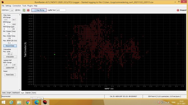

Have you ever tried to start log on your MAF, then drive around 1,5 hour to find out that you are logging on the injectors :shock: :mrgreen:
So here it is, a log on my injectors i cant use for anything! :mrgreen:
After that my laptop run out of power, so not much happened today :)
I tried to do a log on differents things, but different things are missing? please look at the attatched log, what did i do wrong? and yes it is my first log :roll: :lol:
Hope you guys can help me on track :)
romraiderlog_run1_20211122_220111.csv [723.5 KiB]
Downloaded 68 times

Today i got it running better than ever! But now i got clutch problems and i still have problems with the logger.
I forced it in OL and dropped the injector scale from 820cc to 668,87cc suggested from a new injector log.
Then i drove around in a hour with MAF logger and updated the MAF sensor scaling.
The AFR is fine when im driving normal, but if i put the pedal down it runs lean and stalls, i suspect it to be some kind of "cut" from the ECU?.
I would love to share a log, but i dont have succes with them yet, everything looks perfect when i start it, every datapoint reacts etc. but when i stop the log and opens the file, lot of the parameters is missing as the attached log from yesterday, anybody who knows whats wrong?
Is it just me or is it quiet in here? :)

Posts: 7314
The log looks perfectly fine to me. You must be set for a non-en_US locale using ; and , as separator and decimal.

Joined: Tue May 18, 2021 8:40 am
I use open office on my workshop laptop and it seems to the problem, opened it in Excel and it works :)
Thank you for your feedback !

Posts: 7314
Open Office works fine if you set the correct locale in the import window to interpret the decimal and column separator.
