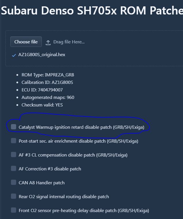

disable secondary air pump operation.
viewtopic.php?f=40&t=8130&hilit=ecuresearch&start=45
https://vk.com/cortin_ecu

So upload my hex, and check catalyst warm up stuff, and download.
Then I can get the rom data with catalyst warmup disabled, right?
Also, can secondary air pump be disabled by disabling ignition retard for cat warm up?
right
can

The patch seems to disable the Ignition Retard, however it doesn't disable the air pump.

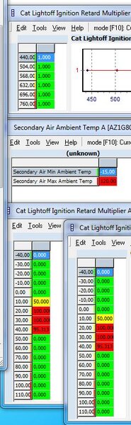

I really need to stop secondary air pump operation before it brokebn.
Is there any threshold for coolant temp or something to disable air pump operation?
My car is JDM 2012 GRB with AZ1G800S flashed.
There is

Thank you Cortin!
That is what I am looking for!
Can you tell me the address for these parameter of definition file?
Or could you please upload definition file of AZ1G800S with these parameter?
