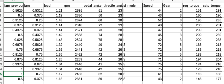

I've been logging most drives to SD card and filtered then queried the data via SQL to find roughness correction where IAM drops. Seems most all of the time this happens whilst accelerating but not enough to have requested torque greater than the engine calculated torque. Has anyone else noticed or addressed this issue please? 2008MY 3.0 Outback.
