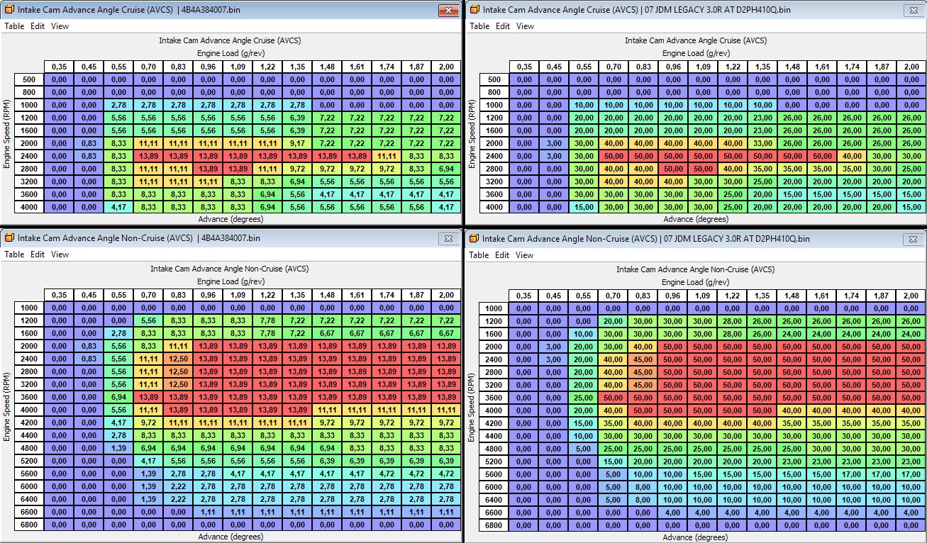

I find it a bit weird that my 2007 3.0 Spec.B would have so wildly different AVCS tables than a JDM 2007 3.0 Spec.B.
Left is mine, right is the JDM one:

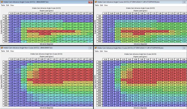

Oh, I just found out how to display raw values - these are the same between both ROMs:
