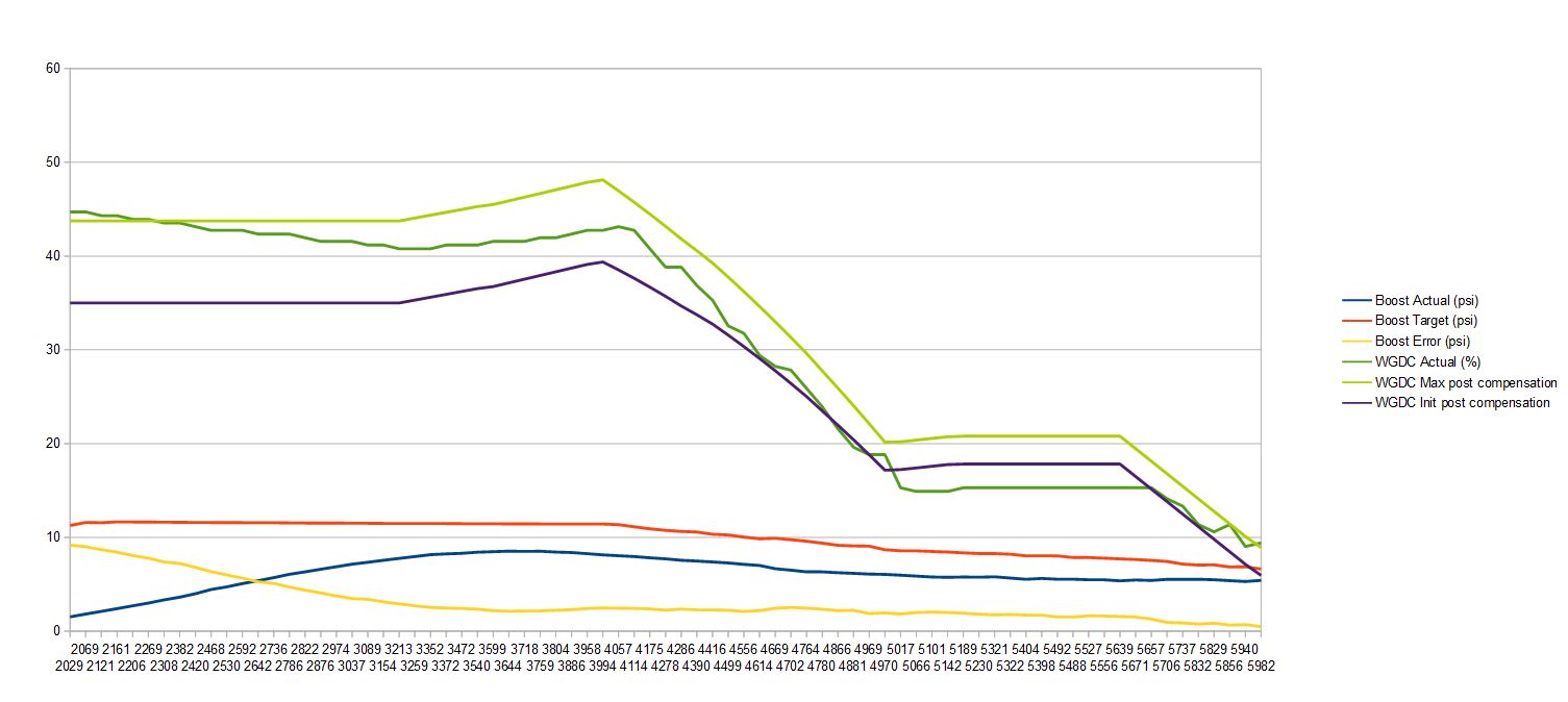

These are the results:
I've attached the full log if anyone wants to take a closer look, but the graph works fine to show my point.
As you can see, the Boost Error is substantial throughout most of the pull. WGDC isn't adjusting accordingly, but actually decreasing way below initial WGDC values.
I took the Init and Max WGDC values from the rom's tables and put them into the graph as well to show what I mean. I do realize those will have been adjusted slightly by the low IAT - still, the actual WGDC curve should at least somewhat resemble the other two WGDC curves, right?
So, what's going on here? Why is the WGDC dropping like this?

have a look at your TD blah compensation (IAT) tables - your IAT is reading 59 down to 52 (f) which puts you in the -34% region of turbo dynamics correction most likely the ECU is pulling a load of duty for you and more as the temps drop even more.

However I think the WGDC is not the issue. You should hit target a lot earlier than the WGDC started to drop. Are you sure you don't have leaks for example? It can be a lot more things that you can imagine. You should log few more parameters next time.

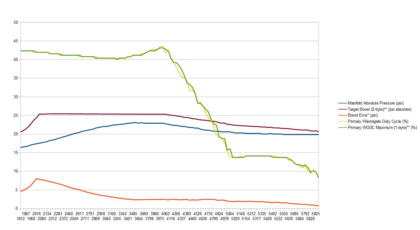

Results:
Now, this still isn't 100% correct because I only added atm pressure compensation to Init/Max WGDC curves. They should be even lower with the IAT compensation added.
While it all makes a lot more sense now, I'm wondering if those WGDC Compensation values aren't a little too aggressive? I'm looking at a quite popular base map for an '09 wrx, atm. pressure compensation is set to -18% instead of the original -70.3%, and IAT compensation is set to -10% instead of -34.4% (at 10°C).
How far should I be able to go safely, without risking the turbo? Is it the simple matter of making sure I don't over-boost or is there more to it?
Atm.compensation is not to prevent overboost, it's to avoid what i think is called "compressor surge", and thus to save the turbo itself.
09 wrx uses a different (bigger) turbo that works better at altitude, that's why there's less atm.pressure compensation.
I think you should focus on the area below 4000rpm first. You should be able to get much closer to target boost in that area, regardless what altitude you're at. 8 psi is barely above wastegate spring pressure, so if this really is what you get, there has to be a mechanical issue, and i would be careful messing with WGDC in that case. ;)
Maybe try logging MAP (Manifold absolute pressure) and Atm.pressure as well, that's how i usually do it.
You could also try to zero your WGDC (set "Max Wastegate Duty Limit Post-Compensation" to 0) to see if you get wastegate spring pressure boost correctly. (should be around 6-7 psi).

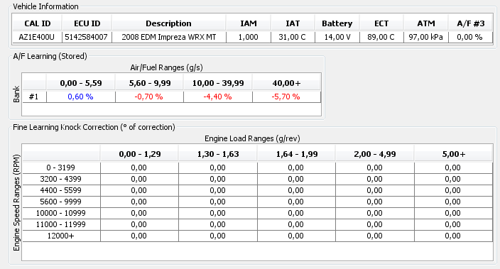

A/F learning looks alright to me..?
The only way I'll know 100% for sure is to do a pressure test, correct?
Just to be sure: I'm assuming the knock sensor does pick up engine misfires as well? Because I got a P0301 code with the car running only on three cylinders about two months ago that lasted about 15 miles. I didn't have my tactrix back then and the car fixed itself before I even got back to the house, but that is definitely something I'll have to look into.

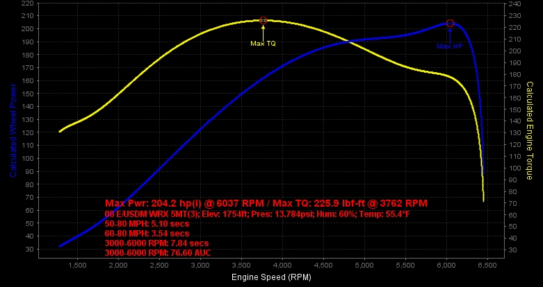

Although I haven't been able to look into it much more (busy with work), I did manage to get a few more logs with the stock rom last weekend.
Logged a bunch more stuff this time, including Max WGDC.
All 5 logs were consistent, max boost starting at 3500 rpm, WGDC pretty much riding the max values all the way to redline.
Again, boost/WGDC is restricted significantly by low barometric pressure (13.78 psi). I checked the pressure recordings for my city on that day and 14.6 psi was the lowest!
So today I checked atmospheric pressure and manifold pressure without the engine running, both were reading low. 14.36 psi at the manifold and 14.07 psi atmospheric while the city recorded 14.9 psi. This difference of 0.8 psi is consistent with my previous logs.
I assume this is part of my problem? The ecu starts cutting boost and WGDC below 14.3 psi and the sensor always reads below that. I'd prefer not having to buy a whole new secondary air pump just because of that sensor, are there any other options?
As to why I'm hitting boost so late, I guess what I'll do next is to run with 0% WGDC to see how it builds boost on spring pressure alone.
Just to clarify, do I have to zero the WGDC tables and flash the ecu or can I just temporarily block off the vac line going to the EBC valve so that only the inlet and actuator are connected directly? That should have the same effect, right?

13.8 Psi doesnt seem unrealistic at almost 500 m Elevation. 14.9 Psi does though.
Btw, in which gear do you take your logs?

Same thing today - the official German Weather Service reported 14.8 psi, while my car's pressure sensor only read 14.07 psi. I get your point, my elevation is 341m and atm. pressure should be a little under 14.7 psi. But I doubt the Weather Service could be off by that much..??
All my logs are in 3rd gear.
Today I pulled the vac line off the EBC and plugged it. Max boost with spring pressure alone is at 5.5 psi. I've attached the logs, one with the stock setup and one with spring pressure boost.
I'll go ahead and tighten the WG arm to see if i can get it to about 8 psi. Maybe that'll help.
