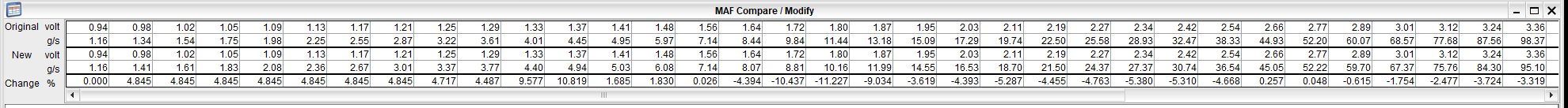

And finally off and tuning.. I mean logging.. Altough i have a stock intake i thiugyht id double check the MAF scale at the start instead of hitting problems later.. This first part is only about 40mins of driving and all highway.. 108,000 lines 0f date..
The more data i give it the closer it is naturallly.. But mainly reading 4% below current scale.

 Post subject: Re: My Learning to Tune Adventure. 2001 WRX GG
PostPosted: Thu Aug 01, 2024 9:52 pm
in the range of +5/-5% i'd be happy enough that the cars in a reasonable state to tune in terms of boost leaks (assuming everything else is working as it should). So get some base settings adjusted - go log a 2nd gear hit as a test and then start dialling in your tables to get it 100% and driving its best.
PostPosted: Fri Aug 02, 2024 5:15 am
Joined: Mon Aug 14, 2023 9:36 am
Posts: 41
I was thinking the same...But there is a little catch to.. Its still using a boost T as its only Boost control Stratergy oh and my foot lol...

Nice to see you are making progress, learning & having fun! btw, that meaga log viewer is super nice!, thank you! i've been using the old MAF scaling log viewer some awesome guy made in the past. far as janky logging--- i sprayed my tactrix & OBD with electrical cleaner & also removed the OBD from the plastic panel below steer wheel. so it's more free floating(only sucks on disconnect, need two hands) the cleaner spray made the most difference tho. aslo make sure you can log all the desired paras when adding new ones, my laptop doesnt like many 2bytes or 4s.
Pretty sure in RR MAF scaling tab, they want you to deselect all parameters when using. get the red dots going. they also updated it (prob 10 yrs ago) where you can hit boost & it doesnt record. the dot will remain at last CL spot till back. I have a question though- does a person log their shifts when doing MAF?? Noob I know but serious question. I recall my dats plots looking like a roller coaster/rolling hills & wonder if that is 100% because of the shifting. guess I can't plot where I "cant go".. so likely doesnt matter. ANOTHER question tho, seems as though you are more competent than I, how would one disable the Fuel trim learning for a solid MAF scaling? unplug the front 02? ha
Goodluck, Glad your whip is street legal now ;)
