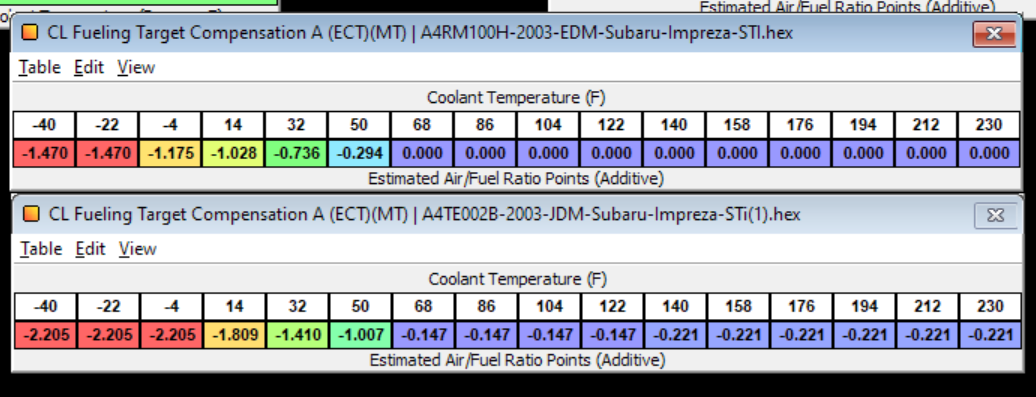

 Post subject: Re: Emissions and maf scaling and AFR
PostPosted: Tue Oct 22, 2024 12:44 pm
Joined: Sat Feb 25, 2023 6:29 pm
Location: Norway
So It seems here we see that the EDM sti has zeroed out the compensation tables to have 14.7 instead of target, overall the EDM runs leaner with less compensation during warmup. Any special reason for this, does it ahve to do with fuel quality? I believe that Japan has better fuel quality to be fair.
ignition timing at idle and low rpm is also much more advanced compared to JDM. I wonder why this big difference, does somebody know?
I Hope its okay that i post my findings like this still new to forums.
I will try to apply this and hopefully the emissions will pass, i wonder how this car passed emissions previously :?:
PostPosted: Tue Oct 22, 2024 2:19 pm
the answer to pretty much all your questions is going to be emissions targets - the EDM car will have a much tighter limit to achieve vs the JDM car and it has to do it on a range of fuels available across europe.
