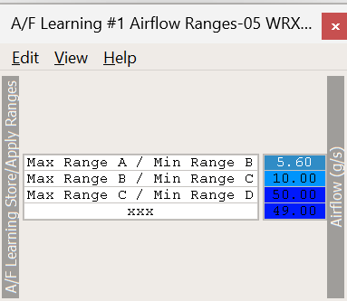

Here is the added airflow range to disable AF Learning D

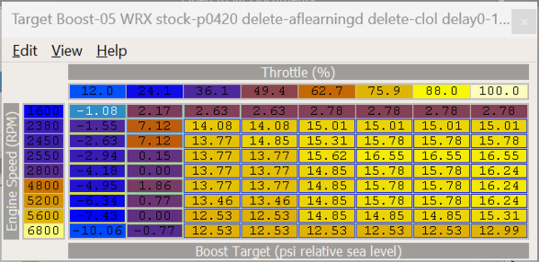

Target Boost Table
