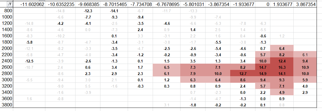

Below are the logging and compensations calculations (+ values = adding % more fuel, - value, removing % fuel)

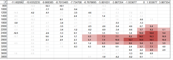

Here with stock FPR/Damper/Bypass and stock fuel rails, didn't like this at all when driving (peak adding 16.3% more fuel - but wider range)

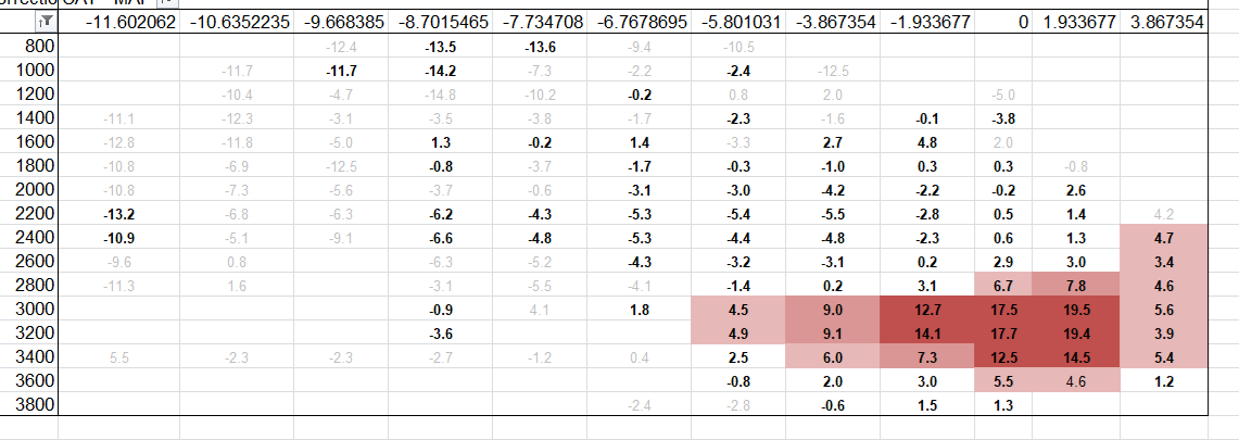

Here with the hose extension in place (it seemed to compress the resonance range, and was easier to tune, but higher compensation values peaking at 19.5% more fuel) - changed its shape, nicer to drive but not right.

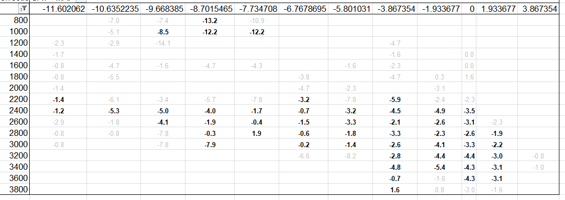

Here with all stock fueling FPR/Damper/Bypass and with the ID1050x injectors in the new Rails - a much more normal looking variance - not adding fuel at all - now normal trim, and like normal car to drive lol - I could hear the difference - its now purring.

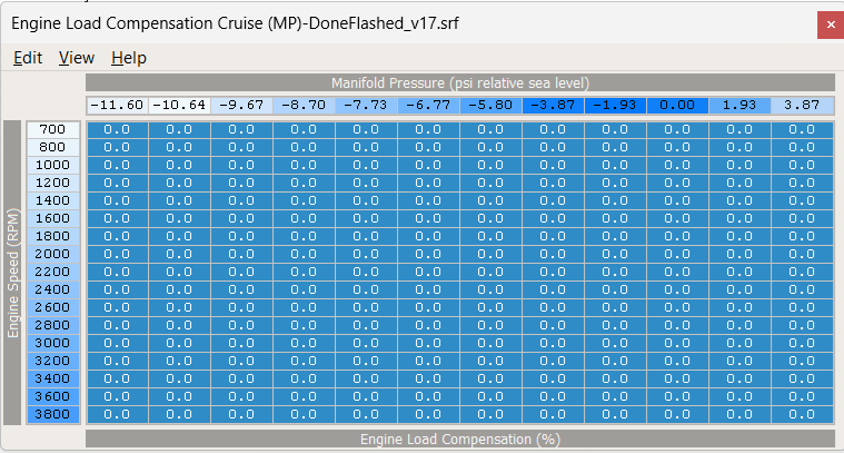

Can you post photos of your new setup and links to what you purchased specifically? I am on a stage 1+ OTS map from 2014 (came with the car) and have started working on my own map for the first time and this was one of the bucket list items I wanted to fix on the car asap. So far the map changes I've started making are only
MAF Sensor Scaling 1.614 Times stock for the larger diameter
Engine Load Compensation Cruise (MP) Zeroed
Engine Load Compensation Non-Cruise (MP) Zeroed
Haven't touched any timing or other fuel trim tables yet, but I was hoping once I flash the completed map I'd see improvement in the stumble with the above.... lol guess not
