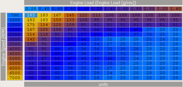

I was able to get the min PW added to the definition, does this look right for the misfire threshold? Is there a reason these haven't been added to the definition files? Am I missing something? I'm using the definitions from this Link.
Thanks for the reply!
[UPDATE: Got everything sorted. The 710 rom seems to have better DBW feel than 700, it could just be in my head. Tried raising the min PW from .57 to .63 and got a smoother idle and no CEL but the car was burning noticeably more fuel. I think in closed loop it was preventing it from leaning out on decel based on the AFR gauge. Figured .57 could just be the resonance frequency for the injectors so I tried .52 and that also seems to be working well! I did that, raised the misfire threshold from 500-1500RPM, and leaned out my cranking fuel tables some. I haven't had the CEL come back after ~300 miles and it's a little happier starting and idling. If there are any more useful tables that can be added for drivability, please lmk!]
