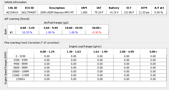

I changed the CL to OL delay to 150 (stock ROM value is 750) and attached the ROM. I added MAP and target boost to my logs. Still no wideband, probably will be able to get around to it in the next few weeks. I selected the Manifold Absolute Pressure (4 byte) parameter but I'm pretty sure what is getting read is relative pressure because the numbers are too low.
Ran a few 2nd gear partial pulls but they all were roughly the same so I only attached two logs. First log (..._072913.csv) got feedback knock kicking in at 4000-4500rpm, MAP hit 8.5psi and MAF hit 134 g/s . But my second log (..._073218.csv) I didn't get any knock but MAP only hit 5psi and MAF hit 109 g/s. I also pulled RR Learning Table Values. AF Learning values look good except for cell #1 but that's not the cause of knock. I've driven about ~100 miles since flashing the ecu with the shorter CL to OL delay so the AF learning should have settled by now.
My initial thought is AFR is too lean at the onset from CL to OL for the that high of a MAF; even though the final base fueling is the same, since there is more air flow that means more fuel which means higher cylinder temperatures and knock. To fix this issue:
a) Enrich the AFR in that area of the Primary Open Loop Table so it's not as lean when transitioning from CL to OL but it's already set to around 11:1
or
b) If I understand the Minimum Primary Open Loop Enrichment (Throttle) table correctly, I enrich these values so this is the leanest the AFR will be at those throttle positions.
or
c) shorten the CL to OL delay even more to 50. I'm just not sure on how it'll affect drivability.
I'm leaning more towards option b but want to make sure I understand the fueling logic correctly.

your fuel trims are looking pretty strong, get your wideband on and see what your fuelling is actually doing - it may be you need to scale the maf more before playing with the fuel targets.
You could even log A/F Sensor #1 and compare it to final fueling base to see how far off they are to get a vague idea how much fuel you're actually getting. If your AFR is miles and miles out compared to target then most likely there's a boost/vac leak somewhere you need to find before you go round in circles for days trying to tune around it.

When the ECU changes from CL to OL, should Final Fueling Base immediately go to the values in the Primary Open Loop Fueling Tables plus whatever the applicable compensations are? Or does is it a slower transition?
I'm trying to understand why my Final Fueling Base is still above 12 after changing to Open Loop when, based on my Primary Open Loop Fueling, it should be around the lower 11's. I looked through all my compensations and it isn't enough to put my FFB in the 12s. Even the AF Learning isn't enough to put it into the 12s. Looked through forums and couldn't find an answer if the FFB immediately transitions (for example ~14.7 in close loop, then once open loop starts FFB goes to ~11) or if the FFB slowly transitions using intermediate values.

if your cl/ol delay is 0 then it will usually drop instantly to the open loop target. Is it possible your engine load is still low enough that your in a 12ish area of the fuel map?

I put a picture of my Primary Open Loop Fueling Table. It is the stock table. In my log my engine load is 1.7 g/rev after going into open loop and continue to go up. This should put me in the mid 11's once I'm in open loop and get richer form there. But my Final Fueling base is in the 13s and high 12s between the point I transition to open loop and Feedback Knock Correction kicking in.
From the CL/OL transition point (@13.9 seconds of the log) and Feedback Knock kicking in (@14.4 seconds) it's about half a second. You're probably right I need to set CL/OL delay to 0 to give the ECU more time to enrich the AF mixture.

I had a peek at your rom and you are right you definitely don't want any transition delay, lean under boost is bad news. Some people fully delete closed loop, but I like it for fuel economy. I zero'd out the delay and smoothed out your fuel table. Feel free to change/richen it up but my cars seemed to like mid-low 11's however everybody is different. Bludgod is right you need to get your maf scaled before you do anything else
