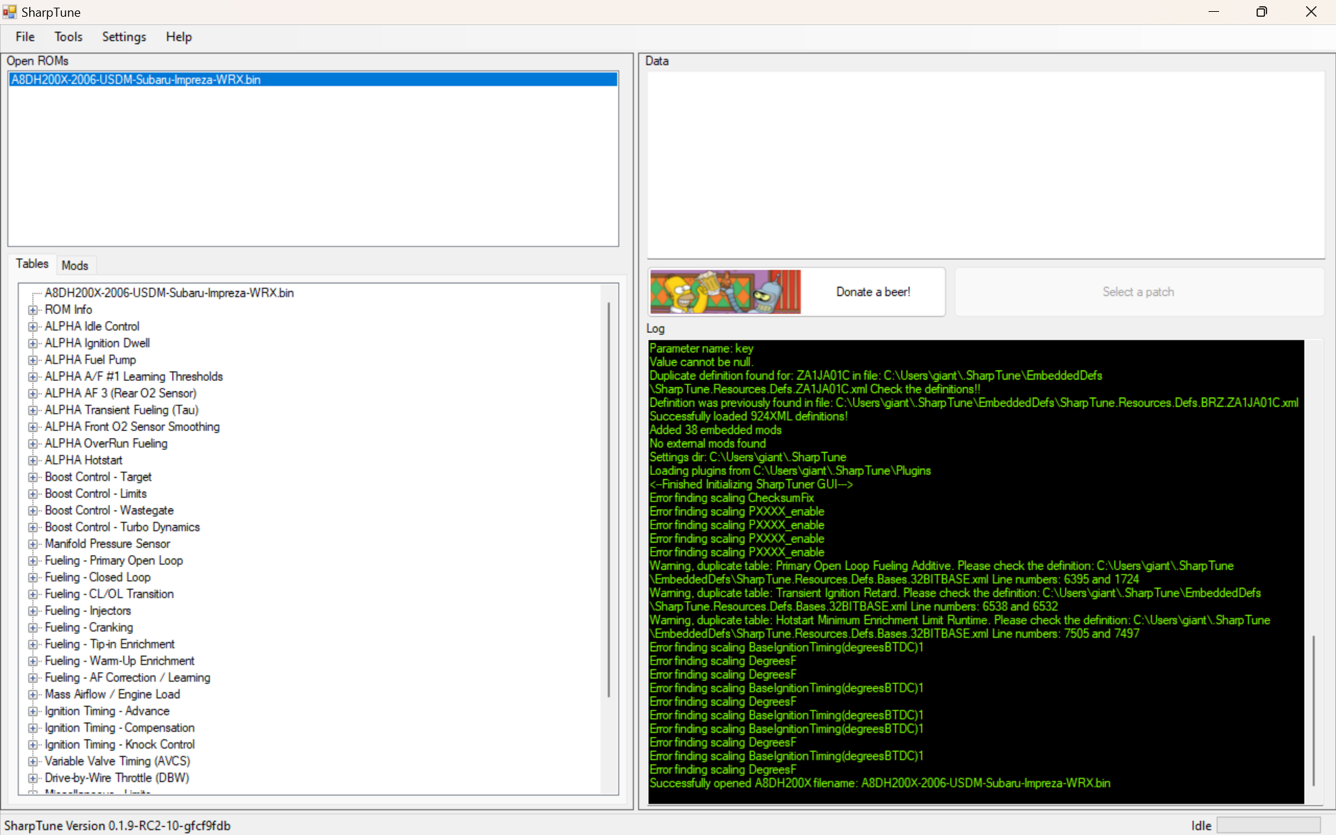

I am currently attempting to patch my rom A8DH200X with merp mod and I cannot find a clear answer if my ROM is supported with Merp, not sure what ROM I need to copy my tables over to. If anyone can point me in the right direction or a compatible rom for me to use with Merp, I would truly apreciate it. Im aware that A8DH201X has a patch availible, but I do know know how to proceed with downloading that patch and installing it. SharpTune is already installed and so are all definitions.
Thanks in Advance. If you are able to patch it for me and help me do it on my own, I am more than happy to commision.

no need to pay, simply click on "mods" next to "tables" on the center left, click on apply mod on the right, save the rom and you're done. what are you trying to do with merpmod?
seems you have the same rom as my car and it won't work, you need A8DH202X.bin

Looking to go speed density, along with FFS and LC, do you know if there is a patch that allows for map switching and ignition cut LC for the 202x?

the 202x patch has everything except map switching and flex fuel. once you select the merp definitions it will show up in ecuflash
