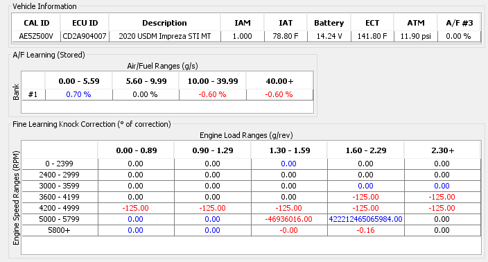

2020 STI with no modifications. Started getting familiar with Romraider and decided to capture a learning view. Has anyone ever seen any knock correction like this? The first thing that came to my mind was an error in the logger definition, but I could be wrong. Any help is appreciated.
Is there any other definition you could try?
What does your logs look like?

I'm using logger definition version 370, which I thought was required with the version of Romraider I'm using (latest version). Attached are two short cruising logs and one short second gear pull. Too much traffic to try and do third gear. 91 octane, just outside Denver, about 65-70 degrees.
