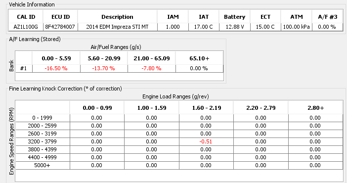

That sounds very worrying. Since this is turning out to be more of a troubleshooting thread I'm gonna go ahead and provide the mod list.

The car is tuned with all these mods. The only difference I made before logging was flashing a rom with WGDC 0.
I'm also attaching a LTV from driving about 150 km (93 miles) with the map that has WGDC tables turned up. This LTV is from before the log I posted.

Is this a ragebait post? Lmao. Friend, you are clearly running extremely rich. Go get a refund/ re vist your 'tuner'.
Flash on stock map. And scale MAF from there, using RR MAF Scaling tool. (Only does closed loop). Then maybe look into some of the awesome spreadsheets others have put together & you can dail in other things.

Not a ragebait at all. MAF scaling for both closed and open loop is on my to do-list. I just thought it was strange that cyl 4 had so much more knock counts than the other cylinders, and that IAM still was at 1.
