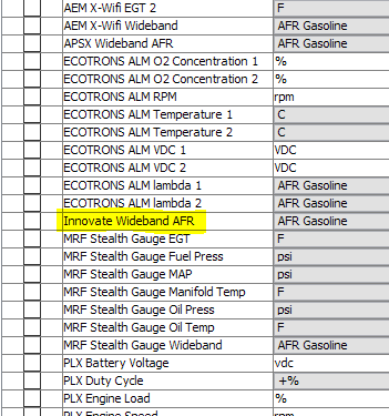

 Post subject: Re: Innovate LM-1 logging into Logger
PostPosted: Tue Dec 02, 2025 1:31 pm
Joined: Tue Mar 18, 2025 2:30 pm
Try the Innovate MTS plug-in.
I only have the Innovate Wideband AFR to choose.
PostPosted: Sat Dec 13, 2025 1:36 am
Make sure you have the 'lm2_mts.plugin' listed in the 'C:\Program Files (x86)\RomRaider\plugins\' directory.
If it's there then you need to install LogWorks3 from https://www.innovatemotorsports.com/support/
Click the Logworks 3 Download link.
This will install the dependencies that RomRaider relies on to access the WBO2 via the Innovate MTS protocol.
