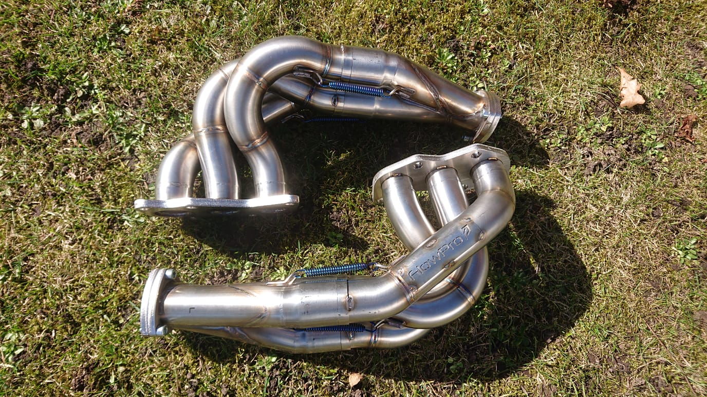

As customary, the car has received a set of custom made headers and full stainless exhaust system (but still retains all three OE catalysts). I have also remapped the ECU to adjust the target AFR maps, DBW maps and ignition maps. Power-wise, it runs great, but over time it has also developed a few bugs.

File comment: The main modification
