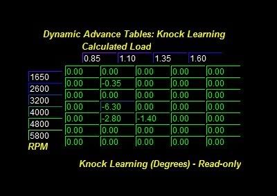

I get the same thing as you in my LGT (same engine).
No FBKC at high loads, but weird stuff at low loads. I have taken up to 8 degrees out, and my learning view still populates with high negative numbers at times.
Like this:
From this thread I started a while ago:
topic3321.html
