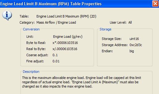

Hi, unfortunately I'm in a wholly different time zone (South Africa), hence the delay in response -
it's a uint16
Address: 0xc2d3c
Endian: Big
Here's a screen grab:

The formula confirms 4 is the largest number you can save in the table in any cell.

Dale - I just had an idea, want to run it past you - the limitation on the table is the combination of it being a 2byte table, so a maximum of FFFF, and the multiplier being 0.000061035156, giving you a maximum of 4.
What if I just change the multiplier (and make sure that I'm using the corrected scaling in Romraider and Ecuflash)? That way I wouldn't need to hack the load axes (I'm beginning to think that my underscaling of the injector scaling that it could be a contributing source to low load hesitation / pulsing, due to AFR corrections swinging too wide).
Any likely issues from doing this? I wouldn't think so, as it's the multiplier specific to that table.

Awesome! Having run the code through simsh, I can confirm that by doubling the multiplier, 7.9998779 as opposed to 4, is loaded into FR1 as the engine load maximum B.
I highly recommend that people who have this problem like me in the '08's up rather change the table multiplier than 'hack' the load axes and lower the injector scalar artificially. I have always worried that whilst I have changed the key table axes (such as fueling, AVCS etc.) that I was aware of, there was probably a myriad of other tables that are significant, but not as yet defined, that were not being changed.
