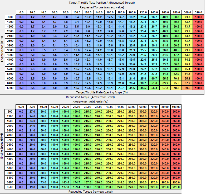

The DBW Requested Torque map on this ROM goes to 360, I have read that one should not exceed the max value from the stock ROM, which was 320. Also, the Target Throttle Plate Position map is max at 320. If anything >320 is 100, what is the benefit of that?
Should the Requested Torque map be scaled for 320 max (i.e divided by 1.125)?

if you want to try both setups and log the difference in requested torque vs throttle angle vs accel pedal then we can graph it out.
