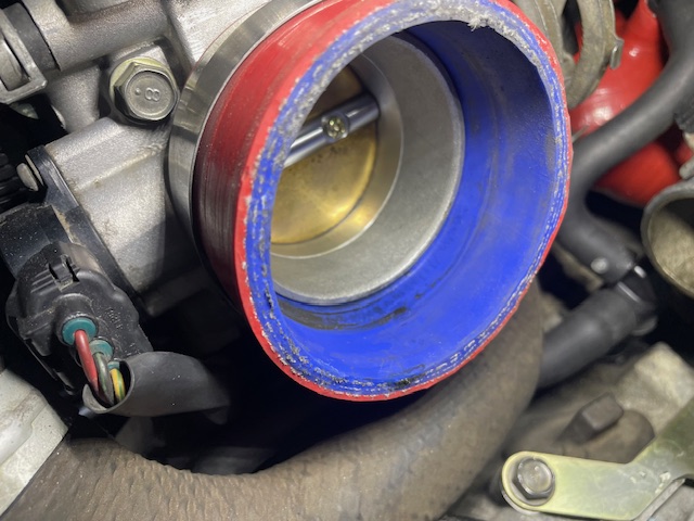

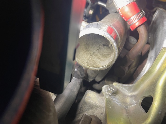

Not long before I pulled the motor I had installed new NGK bkr6eix plugs, when I reassembled it I reused them because they still looked fine. That being said with the KC issues I began to brainstorm and plugs were my first thought. On Monday I had picked and installed a set of bkr7eix gapped to .025, still had the issue although a tad better, and the hotter plugs honestly didn’t look bad. I’ll put a picture in here.
So i pulled the pcv nipple out of the inlet and don’t see any oil inside, nothing I’d be concerned about visible on the suction side which is good.
Then I pulled the intercooler off, and there’s a bit of oil in it, and it looks like I’m getting an oil swirl out of the compressor snout. I had this before I did head gaskets and had cleaned it pre reassembly. Never any oil consumption issues, but it’s not really my daily, I have a truck but drive the wrx as often as I can. Will include pictures…
After looking at that tell me if you think it’s bad enough to cause my issues? I honestly think I’ve seen more oil in some of my other turbo Subarus intake tracts, but I could be wrong. This is my 4th turbo Subaru.
I’m about to check the knock sensor now.
Trey

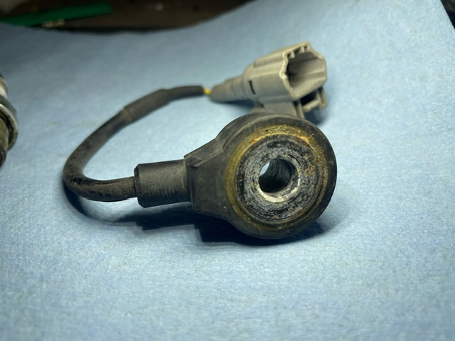

Knock sensor looks corroded but other wise tested fine with a multimeter. 566k ohms which falls within the 4-700k I found online. Cleaning it up and reinstalling it torqued correctly. Pictures are before I cleaned it up of course. We shall see.
