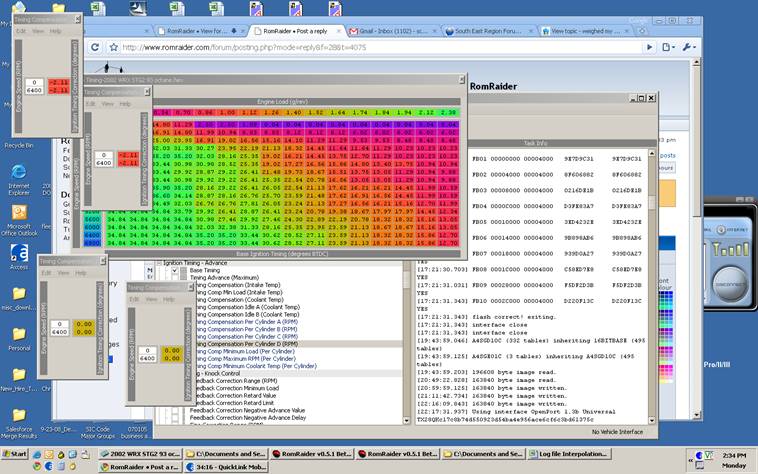

 Post subject: Re: BASE MAP: testes1010 2002 WRX STG2 93 octane
PostPosted: Mon Nov 24, 2008 8:45 pm
Joined: Sun Oct 14, 2007 9:14 pm
Posts: 89
It is enabled on this (base) map.... see the attached image.
PostPosted: Mon Nov 24, 2008 8:51 pm
Joined: Wed Feb 06, 2008 8:10 pm
Posts: 367
testes1010 wrote:
Are you referring to the Per cylinder Timing Comp? On the '02s the values are all zero so I didn't see the necessity for it. Maybe you are referring to something else?
AFAIK, the -2.11 below 6200 is enabled by default for all 02-05 USDM WRX's.
PostPosted: Mon Nov 24, 2008 8:53 pm
Posts: 89
so what is the general view on this... should it be extended, removed, or neither?
PostPosted: Mon Nov 24, 2008 8:54 pm
Joined: Wed Mar 29, 2006 2:04 pm
Posts: 414
Location: Henderson, KY
I looked at wrong on my map, yup its enabled, go ahead & bump it up to redline. It should smooth out the upper end of the timing map on 2 of the cylinders or get rid of the timing comp completely. On my '03 WRX I didn't run any.
