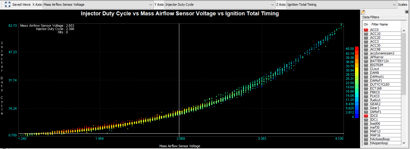

File comment: MAF volts by IDC, with TPS on z-axis
you can see how the open loop TPS base min afr commands a higher IDC than lower throttle for the same MAF volts. I use this instead of a torque reduction from timing per gear or load based acceleration transient something or other

File comment: MAF volts by IDC, with final fueling
