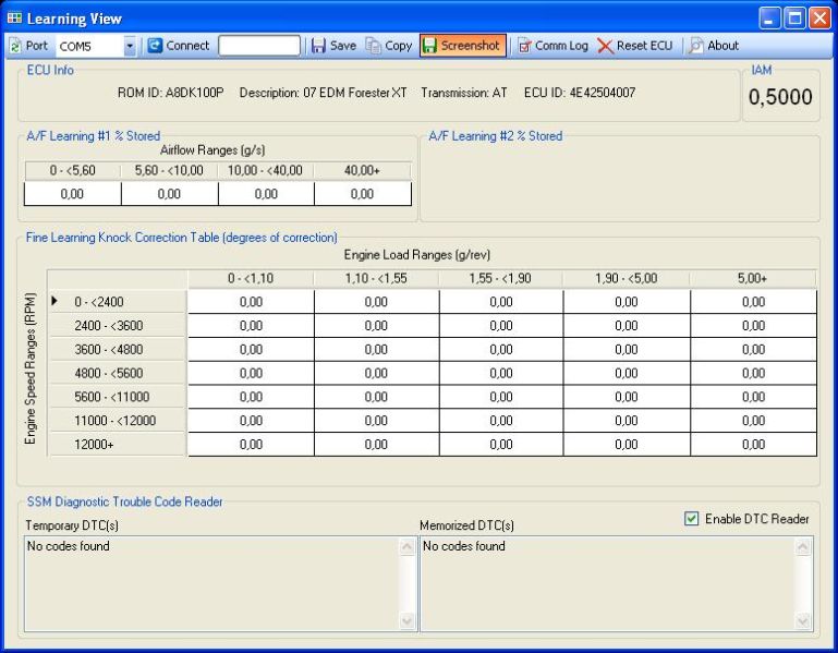

Ok, target boost reached. :)
Attached are the log and learning view from before starting (after new flash) and the other learning view is after 4-5 runs on the way home from work.
More testing tomorrow.
Patrick
p.s. how come the learningview saves screenshots at 605 pix but we can only attach max 600 pix? Going to search for the reason now. ;)
File comment: After a couple of runs
File comment: New flash

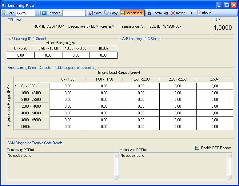

I am quite sure it doesn't have anything to do with knock, but there is a slight hesitation at certain points when doing wot pulls in 2nd. It is barely felt, but I know that it's there. I have to try and log something else to see what it can be....
Anyhow, attached is r6 together with a log and learningviews. Traffic was heavy but at least it gives a little info.
Comments greatly appreciated!
Cheers,
Patrick
File comment: Coming back to the office
File comment: After a couple of runs but traffic was heavy today.
File comment: Just after flash of r6
