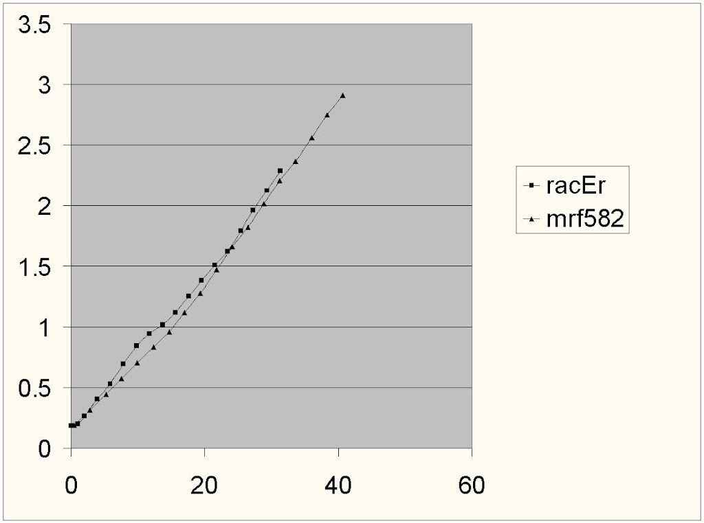

How is the tip-in response with these values? What is your process like to verify proper tip-in?
I generally test tip-in in 1st or 2nd gear since it's easier for my butt-dyno to detect abnormalities. I also make sure I try to stay in closed loop for the duration of the tip-in event. OL masks a lot of the jerkiness. I do slow roll-ons (almost always smooth), quick jab then hold, quicker jab then hold, varying levels of jab then hold etc.. I log delta TPS% and A/F Sensor # 1 Direct. I have spent many miles tuning the tip-in with these modded stock injectors and I've made decent progress. The slow logging rate is causing all the issues. My numbers are quite lower than yours even though I have smaller injectors than these. And in my next iteration, I plan on reducing tip-in even more. Would I be going in the wrong direction? Though, I do run my latencies at the 1.20ms range for 14v... So I guess I can just add .2ms to my values to get to yours?

I added the difference of our latencies to my tip-in and plotted this. Pretty close but my tip-in is still lower than yours. And I want to reduce it even more. Am I going in the wrong direction? It's very difficult to tell.

That's weird, but my logs call for even more tipin in 3-7% tps delta range.
Honestly, I didn't go through many iterations tuning tipin, just made sure that car drives fine and there are no too lean / too rich spots.
