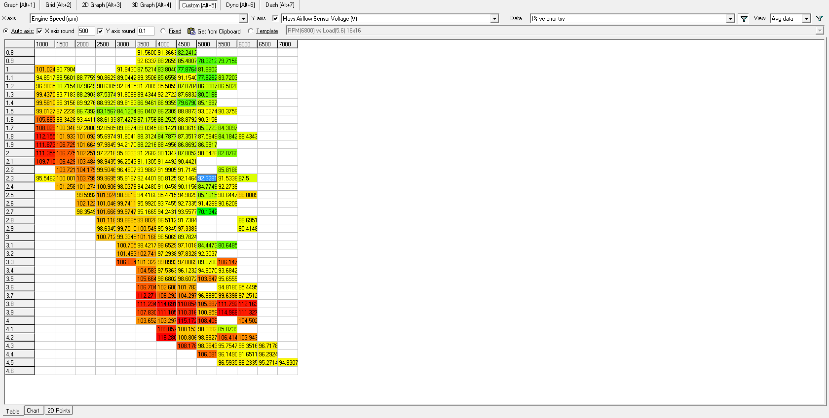

so how can we visualize this trend? we need to look into another dimension of data. let's first consider RPM as that was one of the variables in the example:
File comment: rpm vs mafv
now it's a lot more obvious that for a given mafv (ie, steady mass flow rate) the fueling error follows a trend that runs leaner at low rpms (where load and therefore IPW is high) and richer at high rpms (where load and IPW is low). what is nice about this way of looking at the numbers is that your maf translation table errors are irrelevant: you are looking for trends while holding mafv steady.

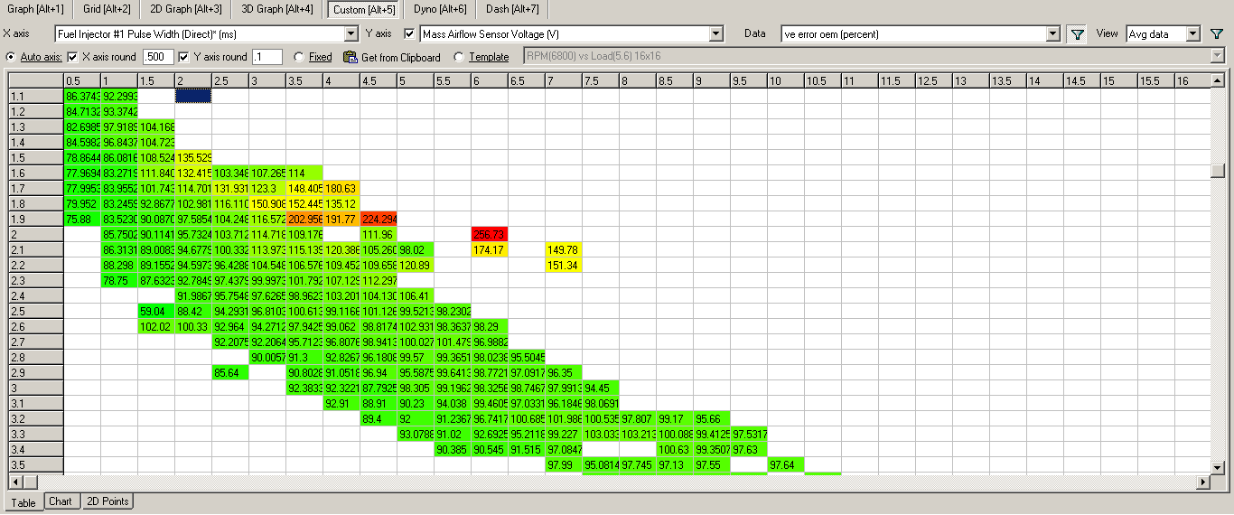

the same data can be visualized by plotting against IPW directly:
File comment: ipw vs mafv
clearly for each row of mafv there's a trend of too rich at low IPW and too lean at high IPW: a classic symptom of latency that is set too high for the injector.

so after reducing latency by 30us (1.16 to 1.13ms) and decreasing the injector scale 3% (from 650 to 630cc/min) i got the following data from the drive home:
driveability is noticeably improved, but the error still isn't level across each row, especially at very low ipw.
i will take it one more step with the same deltas and see how it runs in the morning.
