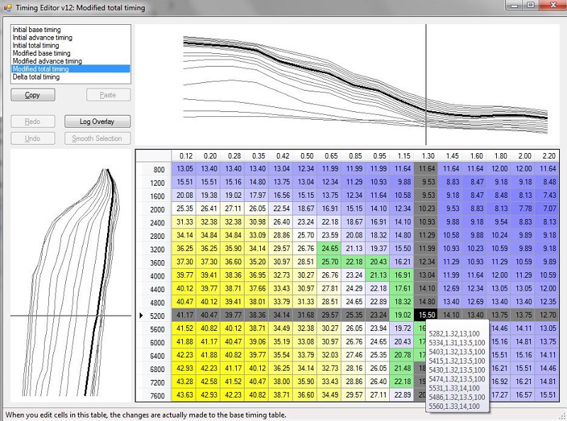

So I de-compiled the timing tool and added an option to overlay a log file. Right now is very dirty but it works.
2013-08-03 16_07_09-Timing Editor v12_ Modified total timing.jpg [ 223.04 KiB | Viewed 10362 times ]

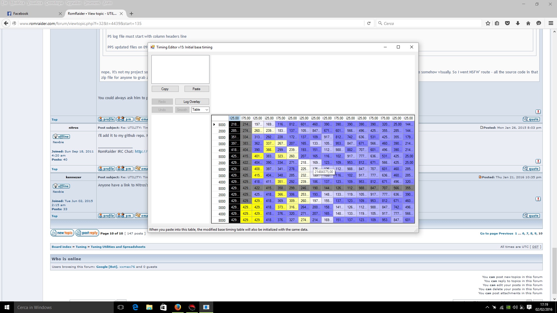

hello to all friends;i'm trying timing editor rev.15 on win 10,copy/paste my tables but it show not correct value...any help from anyone?tnx

no any help guys?
