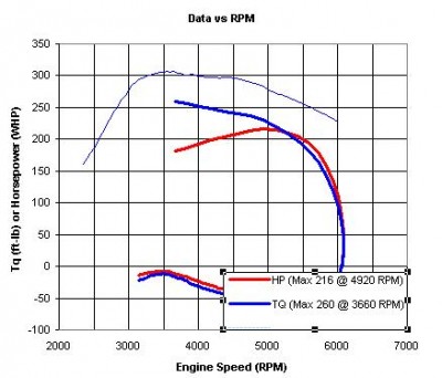

PostPosted: Tue May 06, 2008 8:35 am
Joined: Sat Apr 14, 2007 12:37 pm
something wrong with the graph... please help
PostPosted: Tue May 06, 2008 11:52 am
Post your csv or better, post your xls file that generated that plot.
PostPosted: Tue May 06, 2008 3:59 pm
I am going to guess that the log file has a lot of items (long sampling intervals) and contained data after you let off of the accelerator and was slowing down.
The calculations would have better resolution if only log RPM and throttle (so that you can filter it).
