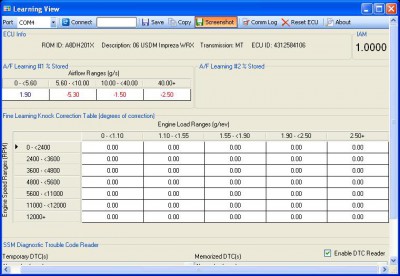

Hi Mikey
I tired to use the speradsheet to scale my MAF.
Attached is my learningview screen cap, and the spreadsheet populated with my log data.
For some reason the MAF (volts) in the Graph Data tab don't show past 2.30. My log data goes all the way up to 2.84.
Do I just apply the scaling up to 2.30v? Or is there a way to fix the sheet so that it goes up to 2.56V (40g range)
And to apply the scaling I just add or subtract the figures in column "S" to corresponding voltages in MAF sensor scaling table in Romraider correct?
Some more info:
Bullwinkles stage 2 map. (06 WRX)
mods
Maddad/Perrin catted dowwnpipe (two high flow cats)
Stock resonated midpipe
Scoobysport Axleback
Prodrive IC y-pipe
Stock panel filter (Had a K&N panel filter, it gave me the same airflow corrections)
I did the logging on a 2hr highway drive, and I believe there is a tone of data above 2.3v,
but for some reason Column M (Average Total Correction MAF Volts only goes up to 2.3v)
Looks like it's trying to calculate data for the remaining rows, but the MAF v don't show up.
