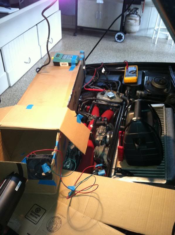

I didn't find this Thread until yesterday. I wasn't happy with the funny IAT readings I was getting w/the standard scaling. I performed a similar test as Bcheck555 did, Except I used a cardboard box, a multimeter, a thermocouple, heatgun, and a dc fan. I didn't think of getting dry ice to get the cold temps. So I don't really have any cold temps. I measured voltage @ the IAT connector which is about 1' down line the sensor it's self. BCheck555 never reported back with his findings using carbibbles IAT Voltage logger defs. So I'm not sure how different the readings are from the ECU. On my rig, temps fluctuated by a good 5 *F, but I feel like my readings @ the higher temps are very close.... not that there are many people driving around in 150 - 200*F heat.
I measured a internal resistance of 1005 ohms, so I don't think I can use Bcheck555's since he has an internal resistance of 1229.
I put my data into a modified version of RyanR's spreadsheet.
This is my first time using the IAT in the intercooler so I'm redoing my VE Table. I haven't had much luck yet. I didn't change my IAT load comps, so maybe that could be the issue. I need to figure out how to modify that.
Edit: went outside and measured temp and monitored IAT... engine dead cold. IAT read 16-18*F and actual temp is 3*F. I wish I had thought of the Dry Ice!
