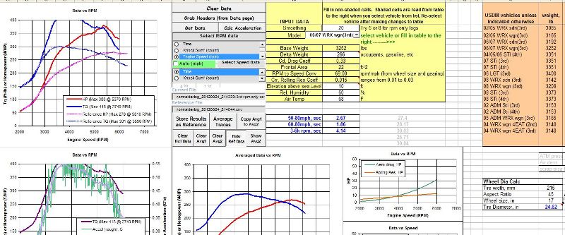

I seem to be getting an erroneous dyno plot that reads way too high when I do an RPM only (with knock sum and TPA) log.
Using the exact same Airboy dyno sheet input parameters (not logger parameters) from a log taken a couple minutes before, but logging many more parameters, I get a realistic dyno plot.
Using snapshot 86b338 of Romraider for logging
4p0z4 Airboy spreadsheet
Three parameter log attached that is giving the bad dyno plot that shows my torque is way too high. I'm wondering if the time base is being calculated or logged accurately?
Screenshot of the Airboy sheet, the reference plot is from a log taken minutes before calculated with smoothing at 10, I was logging 17 parameters in that log (fast polling is cool) it seems to give realistic plot.
I've been encountering strange locking up issues with the logger on the new snapshot version but I've also recently installed a PLX wideband and started logging that at the same time. The wideband data itself will sometimes lockup independent of the other parameters. Sometimes all the parameters will freeze up, after a few seconds they'll come back. No sign of that happening in these logs though.
romraiderlog_20120824_214333-3rd rpm only.csv [32.32 KiB]
Downloaded 658 times
 Post subject: Re: SPREADSHEET: import and graph log files
PostPosted: Sun Aug 26, 2012 3:45 am
Your elapsed times 50-80mph and 3k-6krpm is way lower than they should, for 270whp. In other words, something is wrong with the data log.
