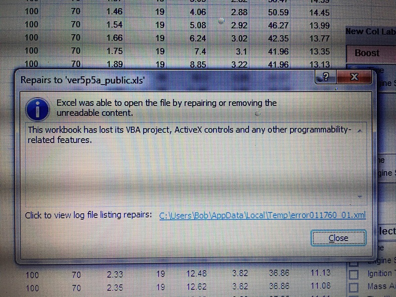

I am having trouble opening the ver5p5a_public file on my windows7 with excel 2010
Its giving us the error "This workbook has lost its VBA project, activeX controls and any other programmability related features."
We enabled all macros in excel settings, but still cannot get it to work.

Here is my fix for the above post. Apparently you get the above message when VBA is not installed.
http://www.asap-utilities.com/faq-questions-answers-detail.php?m=145
Anybody that gets that message try the link i provided, it worked for me.

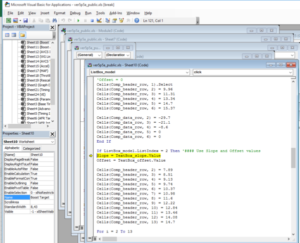

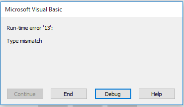

Hi guys Im having the following error, its happening with excel 2016 and 2010 on the same machine. This happens as soon as I open the spreadsheat.

Change the "Macro Security" setting to "disable with notification" and then open the file. It should ask to enable the content and then run in "Compatibility Mode".
I have a laptop with Windows 10 and trying out Office 2016. I can open the file and run the macros. It is rather slow in "Compatibility Mode" but not much I can do about that. It appears that since Excel 2007, MS has been moving away from using VBA macros and a lot of the functionality is gone, hence the need for them to run in "Compatibility Mode"
Excel 2007 in Compatibility Mode still runs the spreadsheet quickly enough.

Thanks for the response bud but still no luck, Iv tried compatibility mode now and tried "disable macros with notifications" and also "enable all macros". Iv tried saving the document afterwords and re-opening it. Even rebooting my machine, still get the same error.
