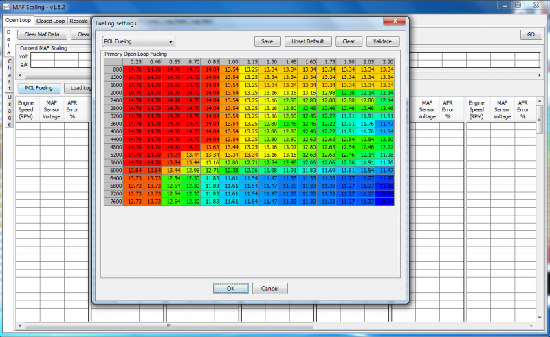

I'm using the Open Loop tab and have a question regarding POL Fueling.
This is my RomRaider POL Fueling:
I then copy the table, paste into the POL Fueling tab and click Validate. I get the following:
The validated POL Fueling Table doesn't have anything above 2.20 g/rev so it uses the last column for higher engine loads which results in wrong readings.
The same thing happens in the Log Stats Tab, Set Axis button.
Am I missing a step here?
The POL table can be set/modified at any time and it extends itself if there are more columns than the table has at the moment of pasting.
I just checked it on my box and it works as expected granted I used my own table with extra columns and your column headers.
Some Qs for you:
- if you had data in POL already did you clear the table first
- after you paste table from RR does it look ok with all the columns or it's already truncated. or the table gets truncated after you click 'validate'? if the first, paste your table in excel and see if it looks ok
- which java version do you use
also, send me your POL in excel and zipped MafScaling folder

Thanks for looking into this. To answer your questions:
1. Yes I had data in my POL Table. I tried clearing it, but still the same results.
2. It is truncated. After pasting from RR, the first column is 0.40 g/rev and the last column is 2.35g/rev. There are no columns greater than 2.35 g/rev.
After clicking validate, the first and last columns go to 0.25 and 2.20 g/rev respectively. Same as my post above.
If I paste first in excel, it works correctly.
3. I have Java 7.67
Attached are my POL table in excel and zipped Mafscaling folder.
Thanks again.
3. I have Java 7.67
Thanks again.
nice catch, thank you. fixed in 1.6.3 (affected are the 3D tables paste from RomRaider)

PostPosted: Tue Jan 06, 2015 6:34 am
Joined: Fri Dec 25, 2009 12:46 pm
Posts: 93
Works as it should now. Thanks!
