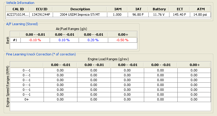

WTF is this..

Posts: 7314
The ECU is responding with 0 for all the queries related to the row/column values.
That's one of those 512kB ROMs right? There's a known issue with them not reporting such data. You can read about it here in the "Known" issues section.
viewtopic.php?t=2772
The table data should still be valid, for now you will just have to refer to your ROM in the Editor to familiarize yourself with the FLKC row/column values that are in use.
Currently RR LTV does not refer to your ROM for the row/column values. This would be a future enhancement.
