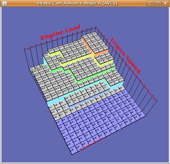

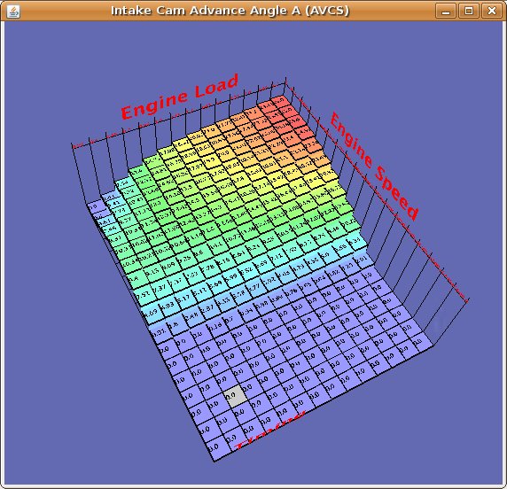

Interpolation, like whats in RomRaider?
File comment: Open any map.
File comment: Select cells to interpolate
File comment: Smoothed/Interpolated
PostPosted: Wed Jun 20, 2007 9:27 pm
No, nothing fancy like that. Just plotting the logged results against the map values, interpolating between map cells like the timing interpolation page.
