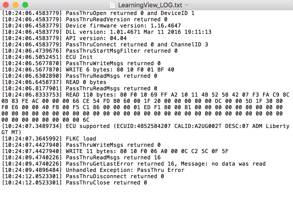

in need of some help...trying to connect to with LV and keep getting error
I have the latest LV, and it seems that when it tries to connect the Ecu ID comes up & the make/model but it stills says error. I have attached a screen of log
Win10 64bit
Screen Shot 2016-05-31 at 10.46.04 AM_zpsdcarjib3.png [ 495.45 KiB | Viewed 6057 times ]
thanks ahead

I had similar issues of late with LV aswell.
Try Learning view in RomRaider which works great! all you need is ecu def added to the ECU Editor.
Let me how you go.

I am also experiencing this same problem with 2 different laptops and 2 different Open Port 2.0 cables. laptop 1 has windows 10 with all the latest updates, laptop 2 has a fresh copy of windows 7 starter installed and is only used for tuning.
I also successfully managed to use the rom raider version of learning view.
In case you dont know how to find it:
Key on engine off > plug in the open port > RomRaider Logger > Tools > Learning Table Values
Does anyone know how to view the tables other than through screenshot?
