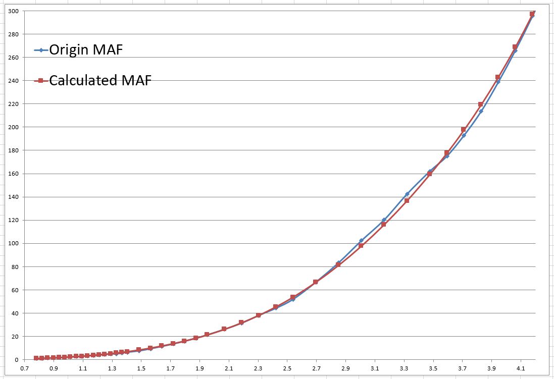

The Default Blue MAF is the Stock USDM 2002 WRX MAF. Red is the calculated MAF and as proof of concept I have matched it verry closely to the stock calibration (for example adjust base and uncover the blue curve). As an example the Default Comparison Curve (Green) is the MAF calibration I use for my vehicle, which has gone through many many revisions to get right.

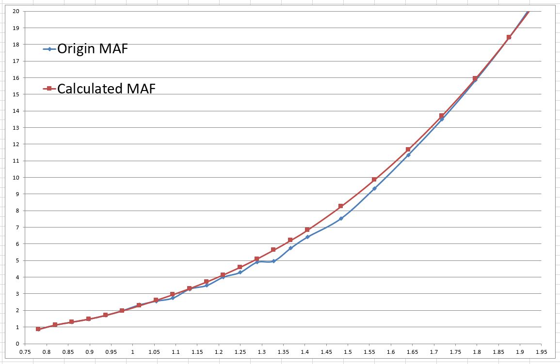

I took a look at the spreadsheet and I see what you mean about the low-MAF rate not being high enough. After you adjust the first 5 boxes on line 6 you want to adjust the boxes in line 11 to continue the process.
I took the liberty of trying to smooth the MAF you provided. There is a dip at 1.211, you see that the %original(Line 9) is only .91. But if you look at the boxes to either side they are much closer to 1. For that reason, if it were my vehicle, I would allow this lower calculated value at V=1.211.
After that you see that the values in Line 9 sort of go up and down, but none of them ever get too far away from 1; That is the target: to get the red line to slice through the center of the blue. The values in Line 9 should not all equal one but you will want to use that line to make sure the changes you have made are not extreme. Check out graphs 1 and 2, they red line rides the middle rather well.
What I did was change the exponent base to 3.2 then massage the values you set in Line 6, then I started adjusting the CAL line. as i went through I found myself going back to spots I had already finished and changing them a little bit to refine points further out on the red line.
I also needed to create a new graph to look at just the very low end where you mentioned it was too low. I Was able to see visually how well the red line was fitting the blue line in that area. And you can see that there is a bump in the blue line.

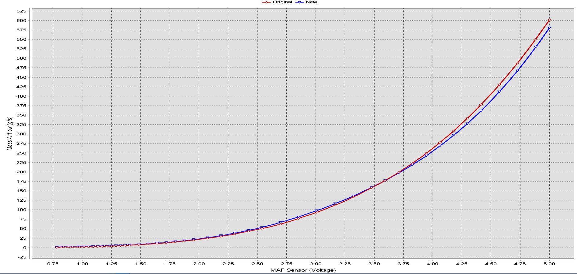

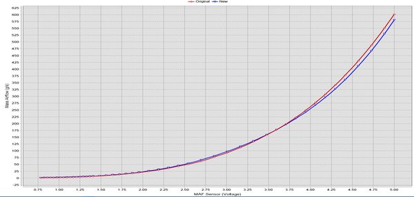

File comment: Full MAF curve plot comparison from VGIs tool (red = stock; blue = latest smoothed)

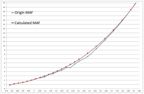

File comment: Full MAF curve plot (blue = before smoothing; red = after smoothing
File comment: Zoomed-in view of the low voltage section of the MAF curve (blue = before smoothing; red = after smoothing)

Had a chance to drive and log with the new shaped/scaled MAF. Impressive!
Looks like I have some more work cut out in OL, but this is by far the best shaping/scaling method thus far.
Does wonders for drivability, especially on the low end - likely a function of how the ECU interpolates between MAFvs and used that to figure out Load, Fueling, Timing.
Thanks a million 86inches!

Yes. The saturation voltage, in this context, is the point on the X axis (int this case MAF V) where the the dependant variable (MAF g/s in this case) reaches its maximum allowed value.
These pictures help illustrate this:
This is the stock 2002 usdm maf calibration
The maximum allowed value for the dependant variable(MAF g/s) is 300 g/s and this value is effectively reached in the final X axis break point at 4.69V, making 4.69V the saturation voltage.
Now take the following MAF Calibration (its not a real calibration just one adjusted arbitrarily to illustrate the point).
This curve reaches its maximum allowed value of 300 g/s at 4.57V, so 4.57V becomes the saturation voltage.
The spread sheet works under the assumption that you know something about the transfer function youre attempting to smooth. For my application I knew that 300g/s would be reached before 4.69V by experimentation and data collection.
With that said, the spread sheet is very flexible. If you suspect that the saturation voltage would actually occur at 6V or even 10V, go ahead and use that number. Likewise if changing this value helps to get you your desired result dont confine yourself to a value that should work but does not.
It may help to just download the spreadsheet and observe what happens when you change the saturation voltage.
If this explanation is not clear let me know and I will try to explain further.

hey 86inches, I took another stab at the smoothing and purposefully leaned out the top of the curve a bit more.
Let me know what you think and if I'm getting the idea of how to use the tool.
I've added a few additional tabs that make it easier for me to zoom in on particular voltage ranges (very low, idle, mid, high etc.)
Would actually be great if I could make CAL adjustments on those tabs to see how the plot changes but flipping back and forth between tabs isn't bad either.
MAF Tool V21_perscitus-21Feb.xlsx [78.46 KiB]
