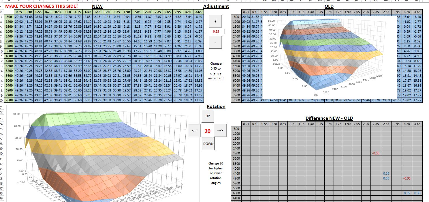

Hi all,
Thought I would share this simple excel based 3D table editor I made. You will need to enable macros to allow the buttons to work.
Features:
- Compare old and modified tables
- 3D map of old and new
- See changes
- Rotate 3D maps
Usage:
1) copy in horizontal and vertical axis values (RPM, Engine Load etc), in the green cells
2) copy and paste as values the dataset into the 2 areas of blue
3) change increment if necessary,
4) click on a cells to adjust in the left side blue cells and hit the buttons to adjust up / down by the increment
5) rotate maps with arrow buttons (the adjustment angle can be changed in the middle)
(note: there is no undo when using the adjustment buttons)
Hope it's useful! :D
Table Editor - 3d Maps.zip [49.53 KiB]
Downloaded 458 times
