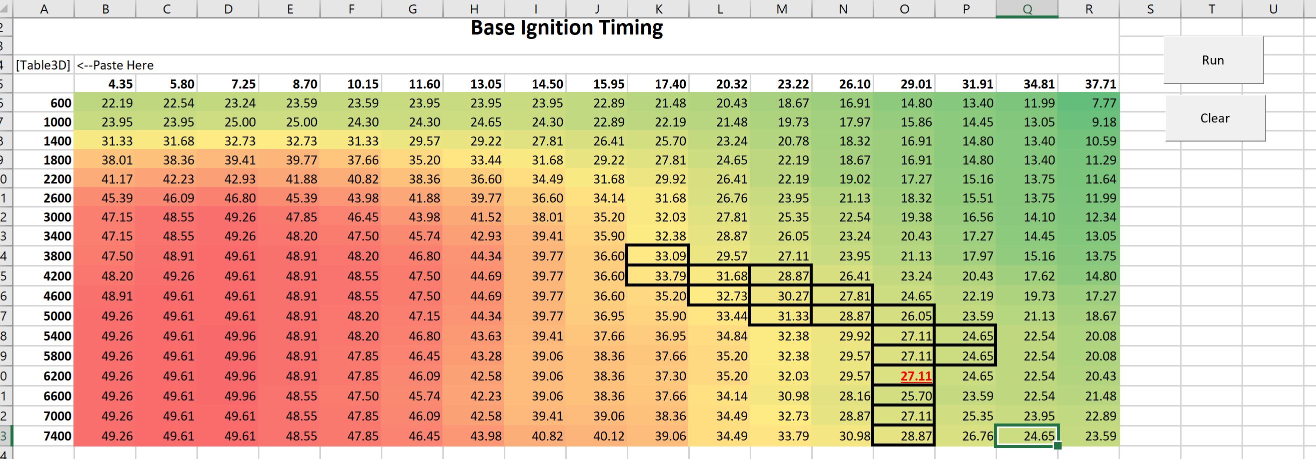

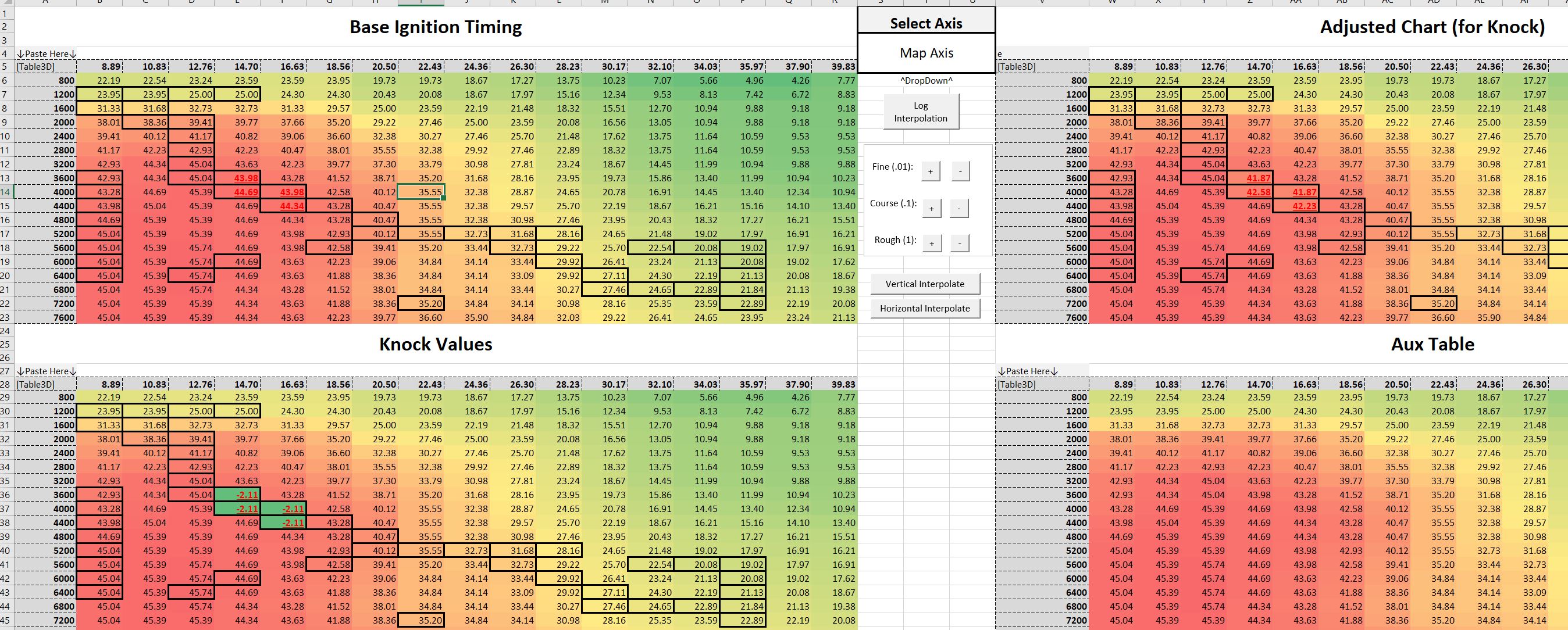

Working on open loop and timing now.
FLKC - is notated in red
FBKC - is notated in blue
Quick question. I have noticed that the 3d tables are not pasting correctly from RR. Is there a fix for this?

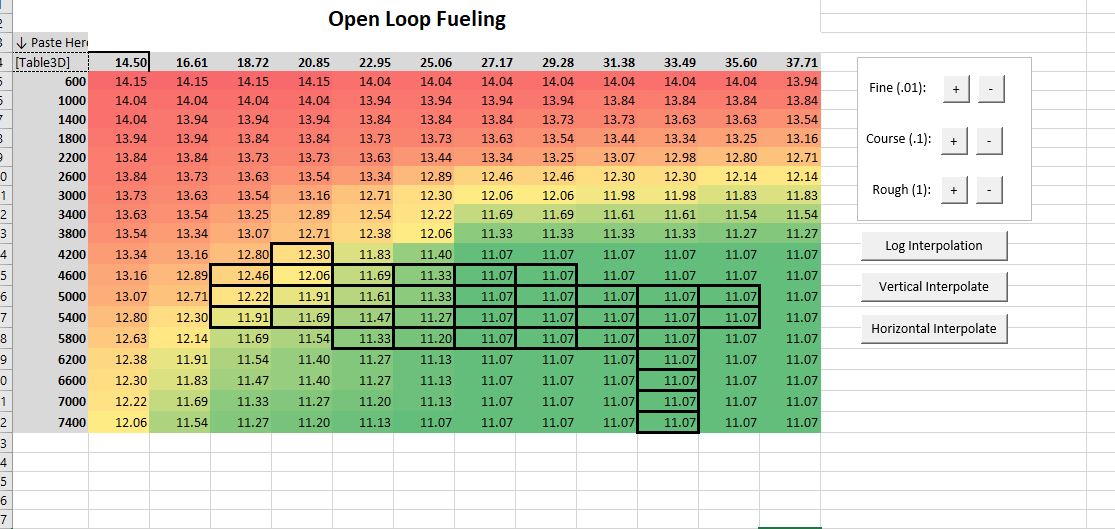

I posted V1.9b on google drive. I had to take out FBKC for now.. Everything is functional but not thoroughly tested. This will be the last update for a while as school is starting up next week :shock:
Timing Interpolation & FLKC mapping
Open Loop Fueling

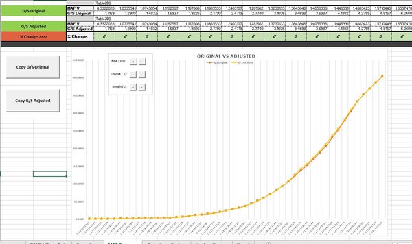

MAF Scaling - some improvements to UI

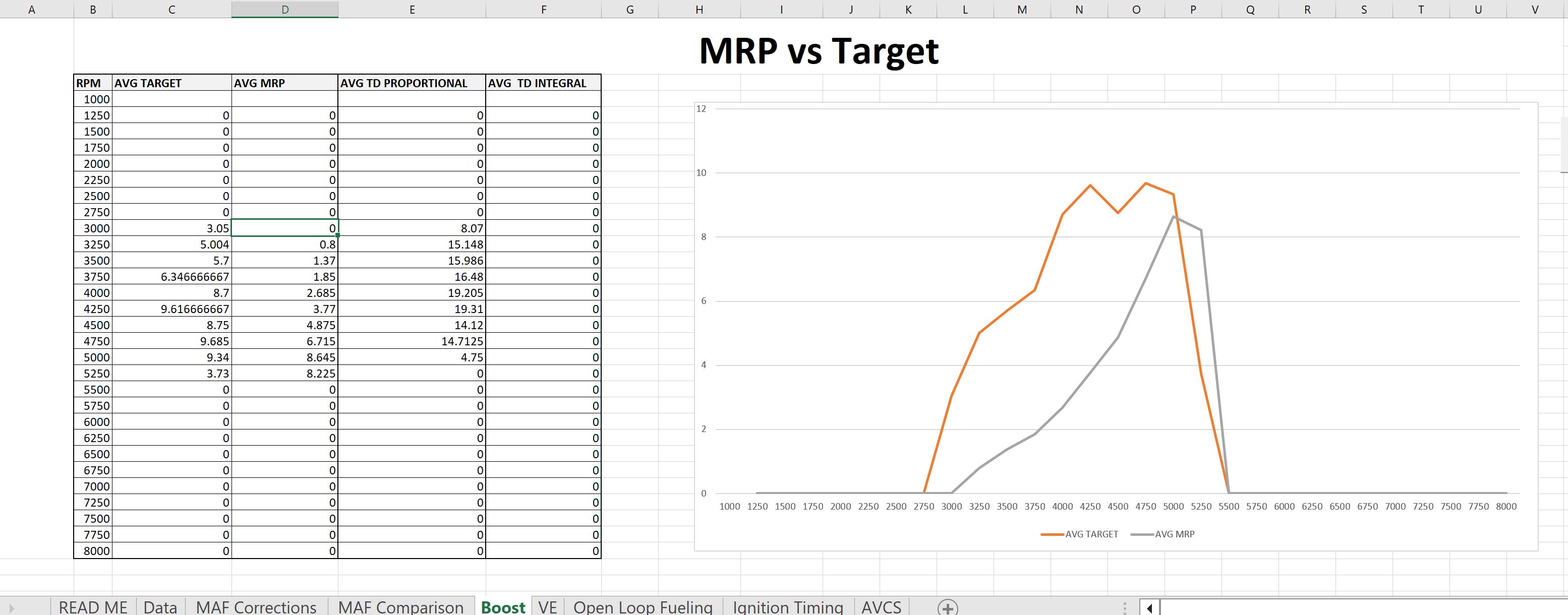

Here is what I have so far for boost. Need to determine the best way to apply changes to WGDC. Currently I don't mind doing it manually.

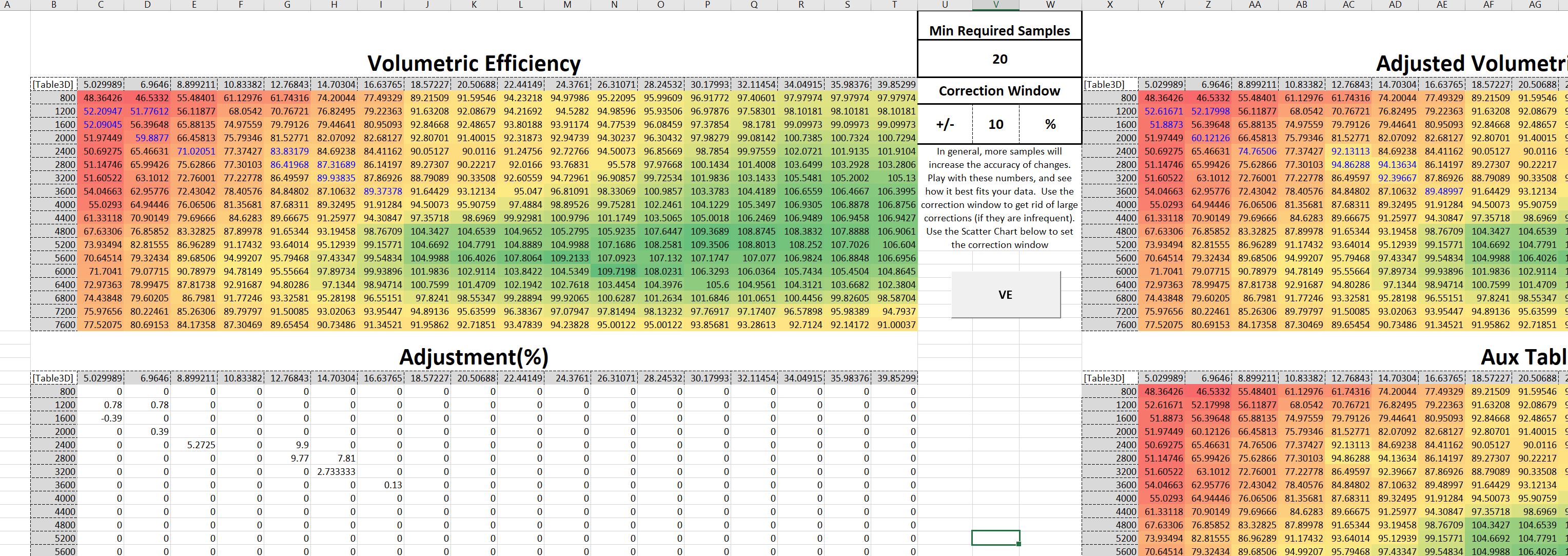

VE works basically the same way a normal MAF scaling program works.. Just 3D. I used a multidimensional Array to store up to 200K corrections for each cell in the table. You can set a minimum number of samples, and specify a window to filter out large corrections.

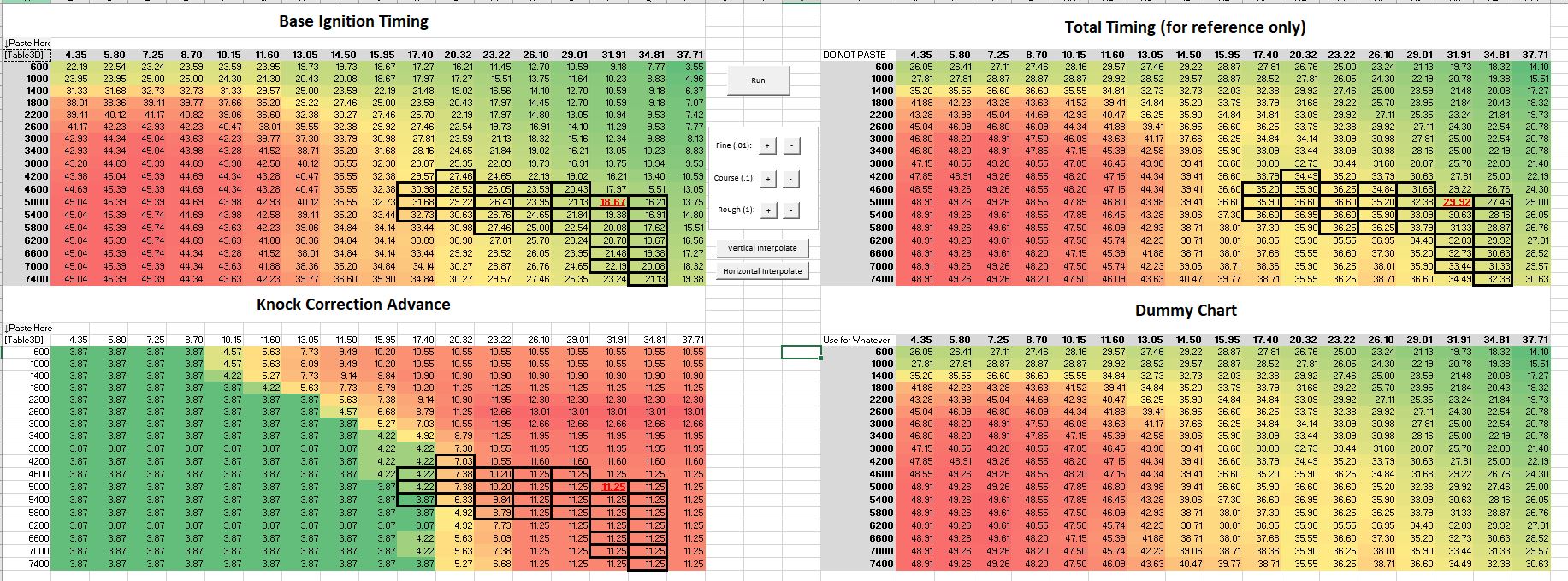

I also made some changes to the timing setup, FLKC in red, FBKC in blue, the changes are applied to the adjusted map.
