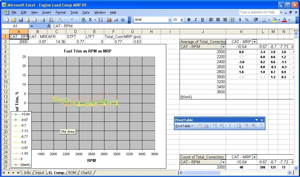

Hi:
I get an error running the Filter.
I have Excel 2002 SP3 on XP SP3.
Dale
Engine Load Comp MRP R1-broke.zip [509.99 KiB]
Downloaded 744 times

Hi:
Dale
In the ROM page, add a column to the end and put 4 or some number that is larger than the highest MRP in your log. You may want to extend the RPM rows to cover values beyond 2000 as well.
 Post subject: Re: Spreadsheet to generate fuel trim pivot table (RPM v. MRP)
PostPosted: Wed Nov 11, 2009 11:24 pm
Thanks, that worked.

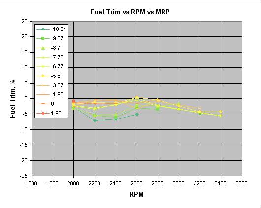

1. Why can I only plot out the data during 2000~3600RPM?
How can I make the other range available?
2. I feel my 1st/2nd gear startup is not very smooth in slight throttle. Is it possible due to RPM vs MRP fuel trim not correct?
Attached my current result for reference below.

File comment: My current RPM vs MRP fuel trim

sega wrote:
Hi,
Check the 2nd post above yours.
Can't say. Your plot looks OK though as the corrections are only a few percent off.

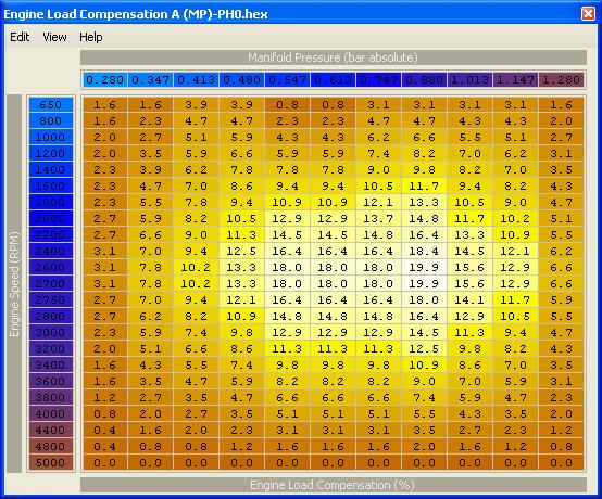

Airboy...
Can you please prep another similar spreadsheet to accommodate the 2008 Hatch STI's (Canbus ecu)...
And can you please allow for the attached rpm and MP range, as per the attached image...???
PLEASE DUDE!!!
Phoenix

Phoenix wrote:
Airboy...
PLEASE DUDE!!!
Phoenix
You can use the spreadsheet for any ROM that uses the MAF compensation MRP table. Just change the header values in the "ROM" page. It was originally made because the '08+ STi had strange response in this area.
