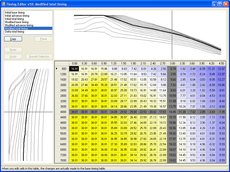

How to use:
1. Copy your base timing table from RomRaider to the timing editor.
In the timing editor, select "Initial Base Timing."
In RomRaider, open your "Base Timing" table, and use "Edit, Copy Table" copy the the values to the clipboard.
In the timing editor, click Paste.
Your base timing table should now be visible in the editor.
2. Copy your advance timing table from RomRaider to the timing editor.
Same as above, but:
Copy from RomRaider's "Knock Correction Advance Max"
Paste into the editor's "Initial Advance Timing."
(Some cars have multiple pairs of base and advance tables. Make sure you're using the base and advance tables from the same set.)
3. Move the mouse over the cells in the table, and watch how the table's shape is displayed.
4. Select the "Modified" base or advance tables, and notice the help text at the bottom of the window.
5. Make changes to the "modified" tables. Note that the "total timing" views can be inaccurate if your base and advance tables have different row and column headers.
6. Copy the modified base/advance tables from the editor, and paste them into RomRaider.
7. Double-check everything in RomRaider.
8. Flash, log, repeat.
I cannot stress the double-check everything in RomRaider step enough.
If you find a bug, please let me know. But if you blow up your car, that's your problem, not mine. :)
I flashed my car with tables created by this tool, so obviously I trust it that much.
But you shouldn't trust me, you can only trust yourself.

v12: Pressing '+' or '-' will increment or decrement selected cells by 0.35

File comment: Screenshot
